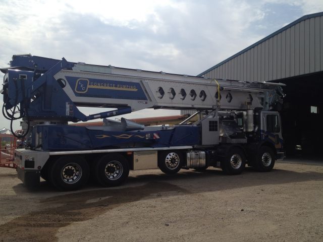

we just got new tb110 putz sweet machine |

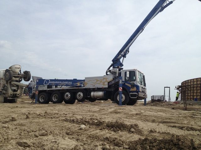

also matches our 2012 40 z putz |

You sure you don't need an operator for that 110?!! Nothing better than new paint! |
| Travelteck | 10-21-2012 | reply profile send pm notify |
It is sure to see some new equipment out there. Nice |
