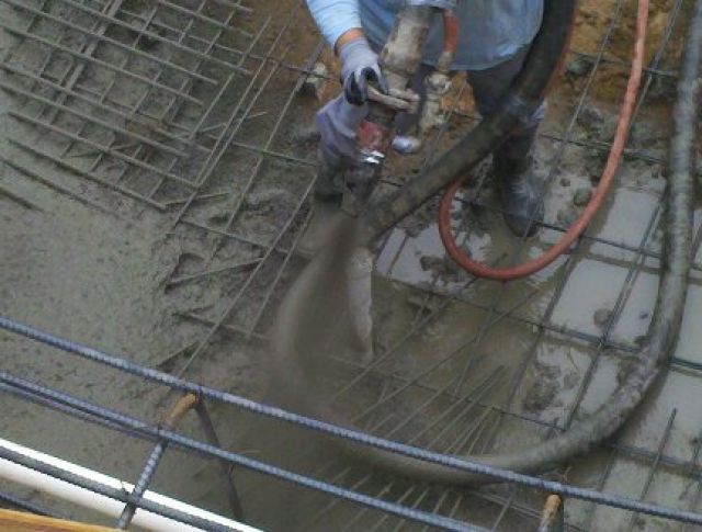

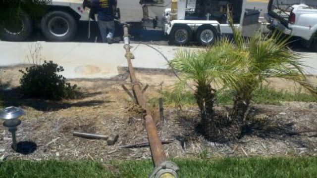

i do shotcrete twice a week with my olin 565. word from the wise run 2 1/2 in pipe all the way to the pool then reduce it to 2 in hose and run fifty foot hose in the pool because the cutters will like you a hell of a lot more with less clamps cacthing on the rebar when they r draggin the hose . also my reason for running 2 1/2 in pipe to the edge of the pool is one i feel pipe is better on the pump and 2 if your running your system over exsisting concrete pipe moves very little if any at all and to make sure your not causing any damage get a bunch of 2x4's and cut them a foot long and puttm under the pipes just after the clamp and one other reason for running 2 1/2 in all the way to the pool is if you plug you dont want 2 plug at the pump it be better if it happened at the pool because its mostly dirt around it or already messed up sand dirty from all the work going on. on the wash out i blow out my system with air and hook one 2 1/2 in hose from the pump to washout hook and 4 to five hoppers later good to go. also becareful when using air never hold the vslve wide open just quick little spirts of air with pauses in between each time. of course everybodys different in how theydo oit and could also tell u my way is wrong but it works for me and gets the job done safely. over the years you will find what works for you best. any questions you can message me anytime |

also one more thing that ive found useful to me . nine times outta ten you will plug in the 2 1/2 to 2 in reducer so stay by the reducer and try to at all times have a visual on the nozzle man. it will plug in the end of the nozzle and if you dont catch it in time somebody could get hurt |
