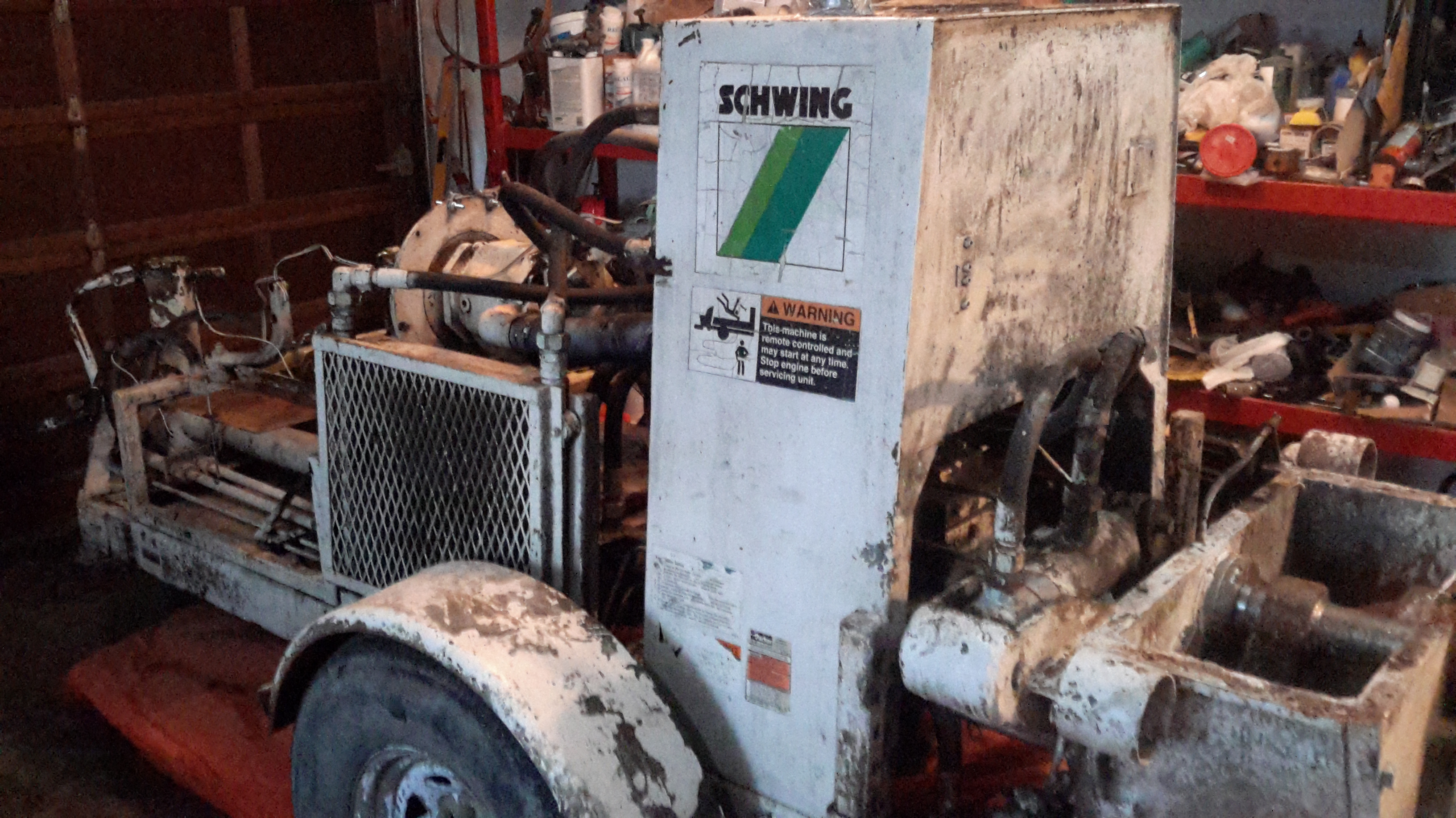

| Pool man Travis | 02-02-2017 | comment profile send pm notify |
I have an early 2000s bpa 500 with a spun crank Bearing. The engine shop quoted 10k to rebuild the turbo 4cylinder German Duetz motor. Another shop that specializes doing custom vehical builds said they can put a v8 gas motor in place for less then half the price. They tell me this new motor will be more powerful and able to run a good size air compressor as well. Does anybody see an issue in doing this swap other then the increase in fuel consumption. |

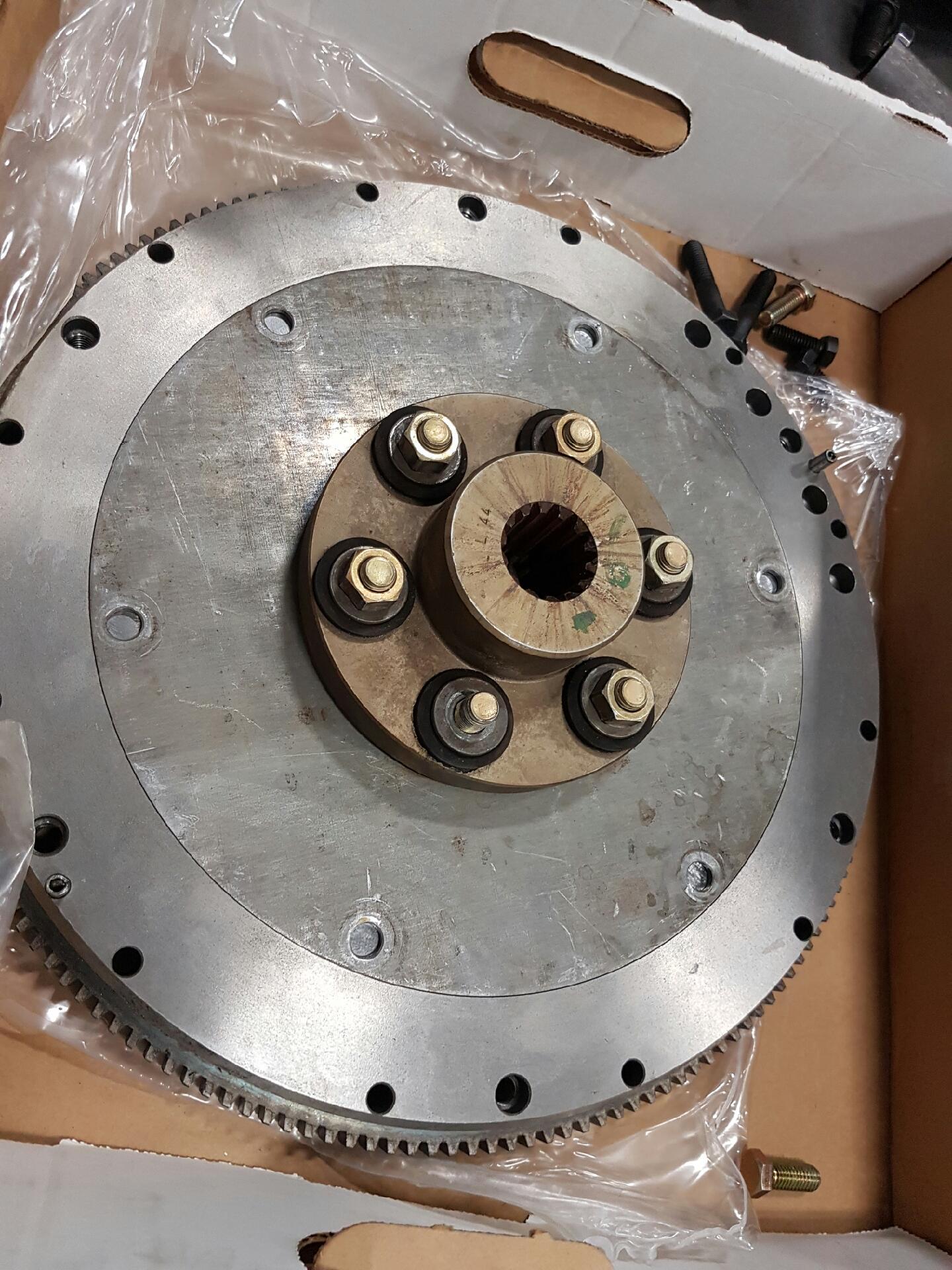

| Pool man Travis | 02-08-2017 | reply profile send pm notify |
The fuel economy will go way down and I am ready for that. I already picked up a used LS motor. The specs say it has over double the torque and hp at every rpm so we are asuming that is all the hydraulic pump recconizes. This shop specializes in these gm motors and is able to limit rpm in the tune. The coupler was affordable to get done through a machine shop. Next is figuring out the bellhouse. |

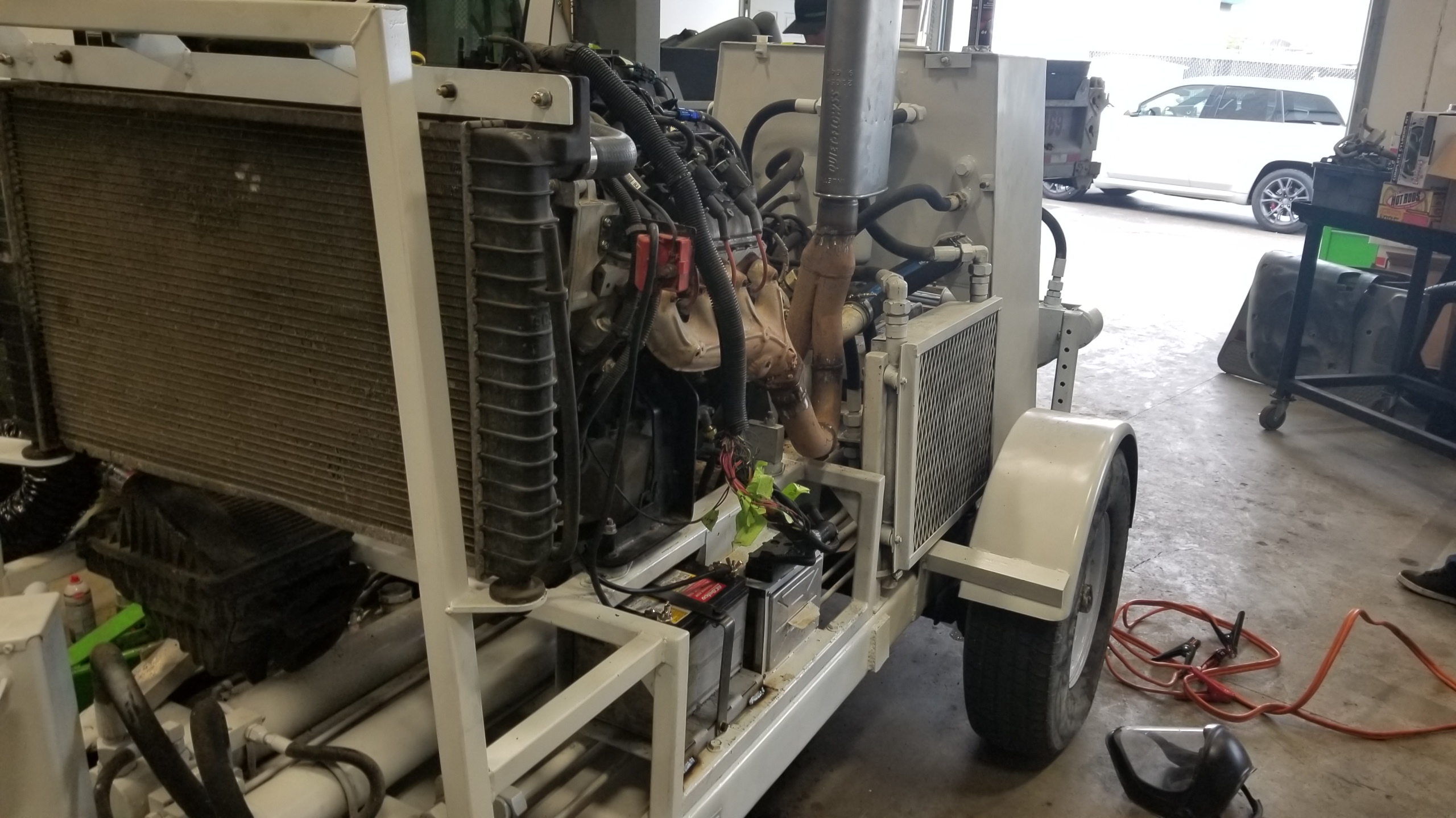

| Pool man Travis | 05-12-2017 | reply profile send pm notify |
Motor is in and running great. Pumps water like a dream.. Next week will be the real test. Quit and nice sounding pump with the LS motor |
