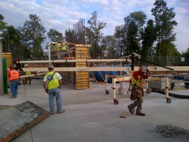

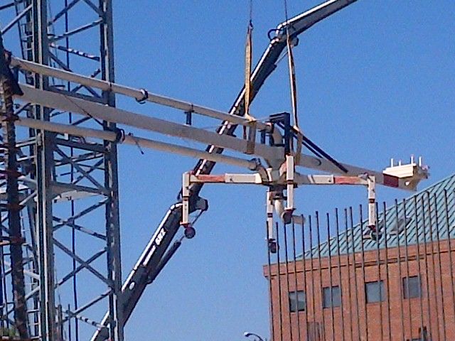

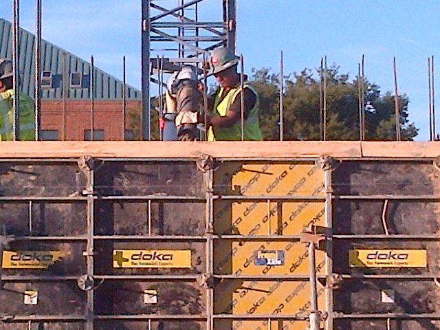

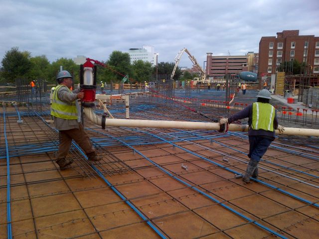

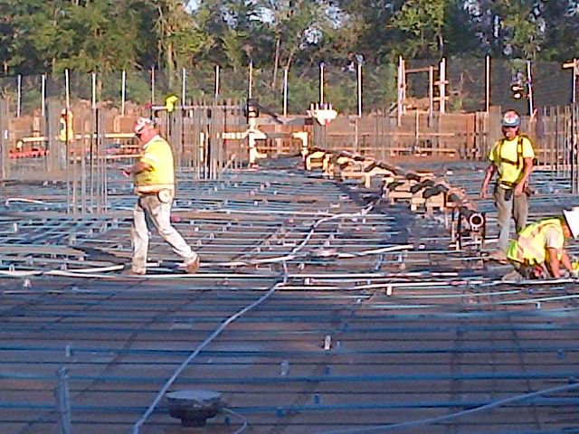

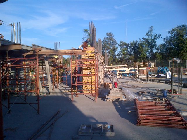

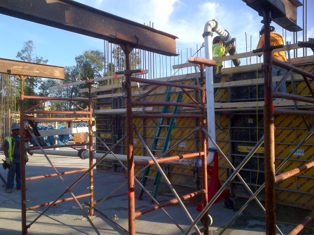

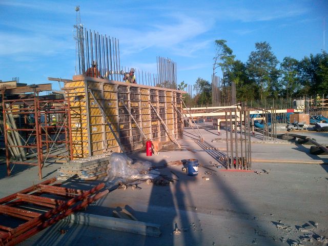

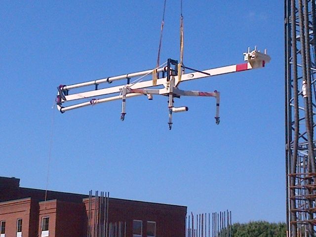

They told me that a crane and bucket was not approved by the GC, it is actually faster to pour this way, pipeline and placer can stay connected for several days, only having to add pipe as we go, only thing bucket was used for was to blow system clean |

A good reason for an oiler on this job, I could think of some easier ways of doing it. I bet they think it is just great. LOL |

The GC didn't want to tie his tower crane up on a hours long bucket pour while the other trades stand around waiting for a lift. |
