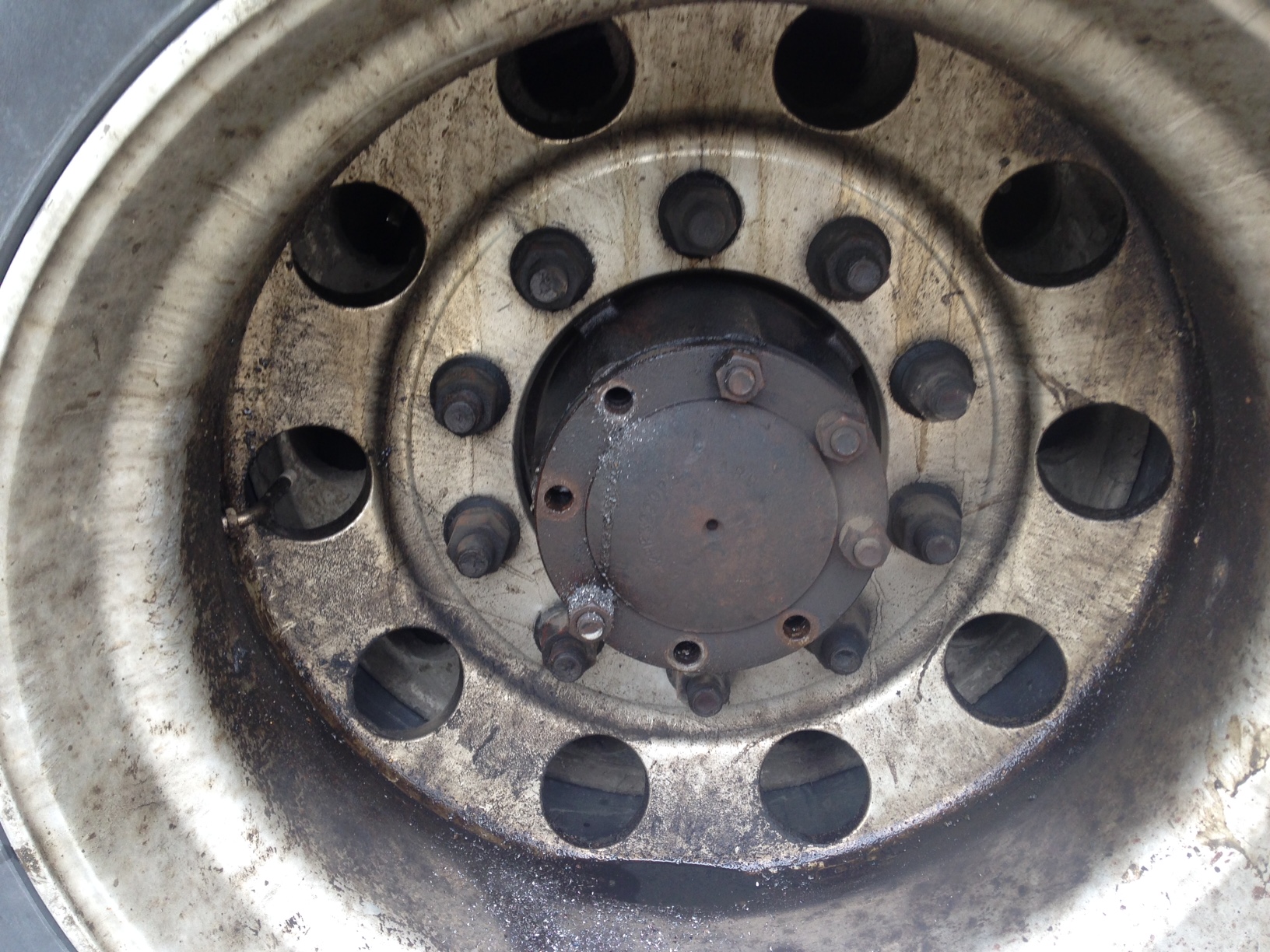

Huh ill check, today it was better.It seems like when i stop and idle for a while it goes on then when i drive it goes off. On a different note: i just got in from the shop i had 5 bolts shear off on my rear axil hub. I had to drill them out and easy (not so easy) out. Lucky i got them all out and replaced i have a big day tomorrow. |

Sheared off! or maybe when the last guy installed the axil he over torched them with a 3/4 impact. |
