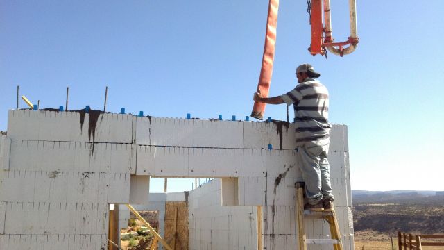

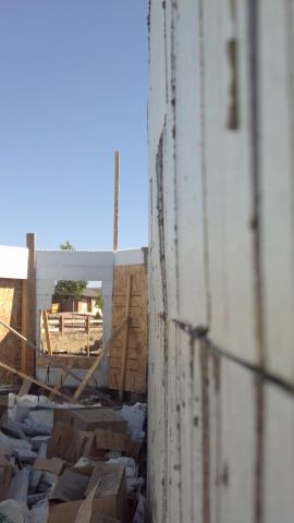

Well, 20 yards and 4.5 hours with 6 blowouts. CHA CHING. It beat dragging the hose around. I pumped them with the volume all the way down, concrete just oozing out of the snake, and they still couldnt hold. These were assemled???? like my kids put them together! ok maybe not but holy cow! thankfully its over and now it is the roofers, framers, stucco guys problem! |

That's some of the worst IFC wall forming I have seen. And thank you for the undate |

WOW WEE, Maybe they wanted curved walls................adds character............... |
