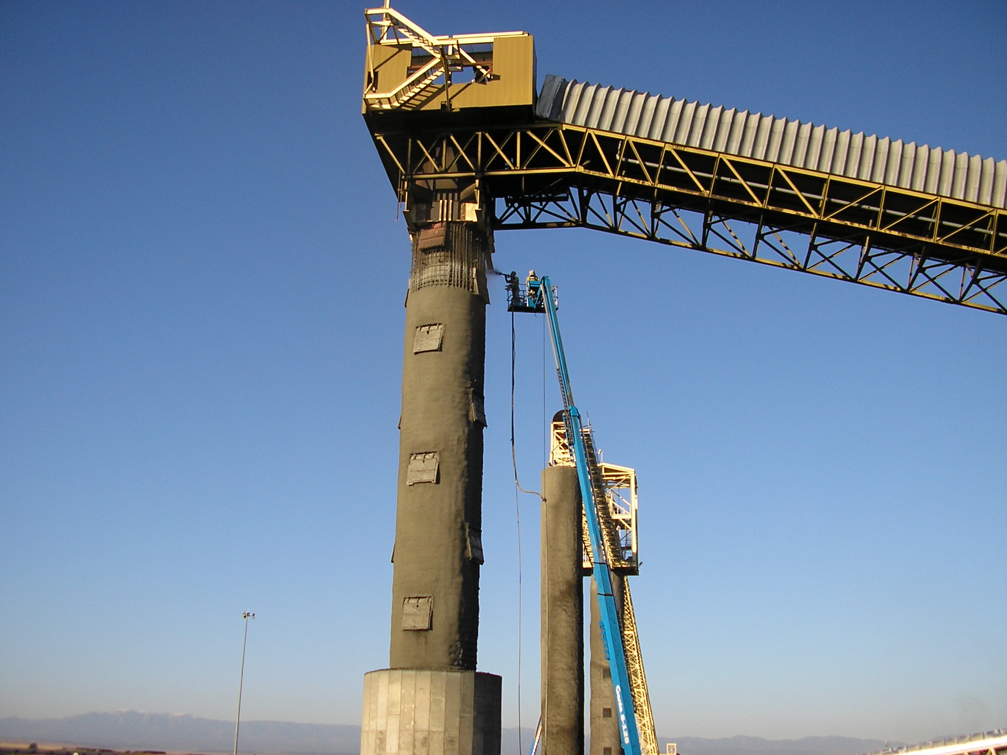

| Logger | 03-05-2018 | reply profile send pm notify |
We run all REED pumps and it has never been a problem to pump up vertically. We have done Shotcrete 100' straight up on Silo work with no trouble. It is very doable and we often use ours in similar applications. |

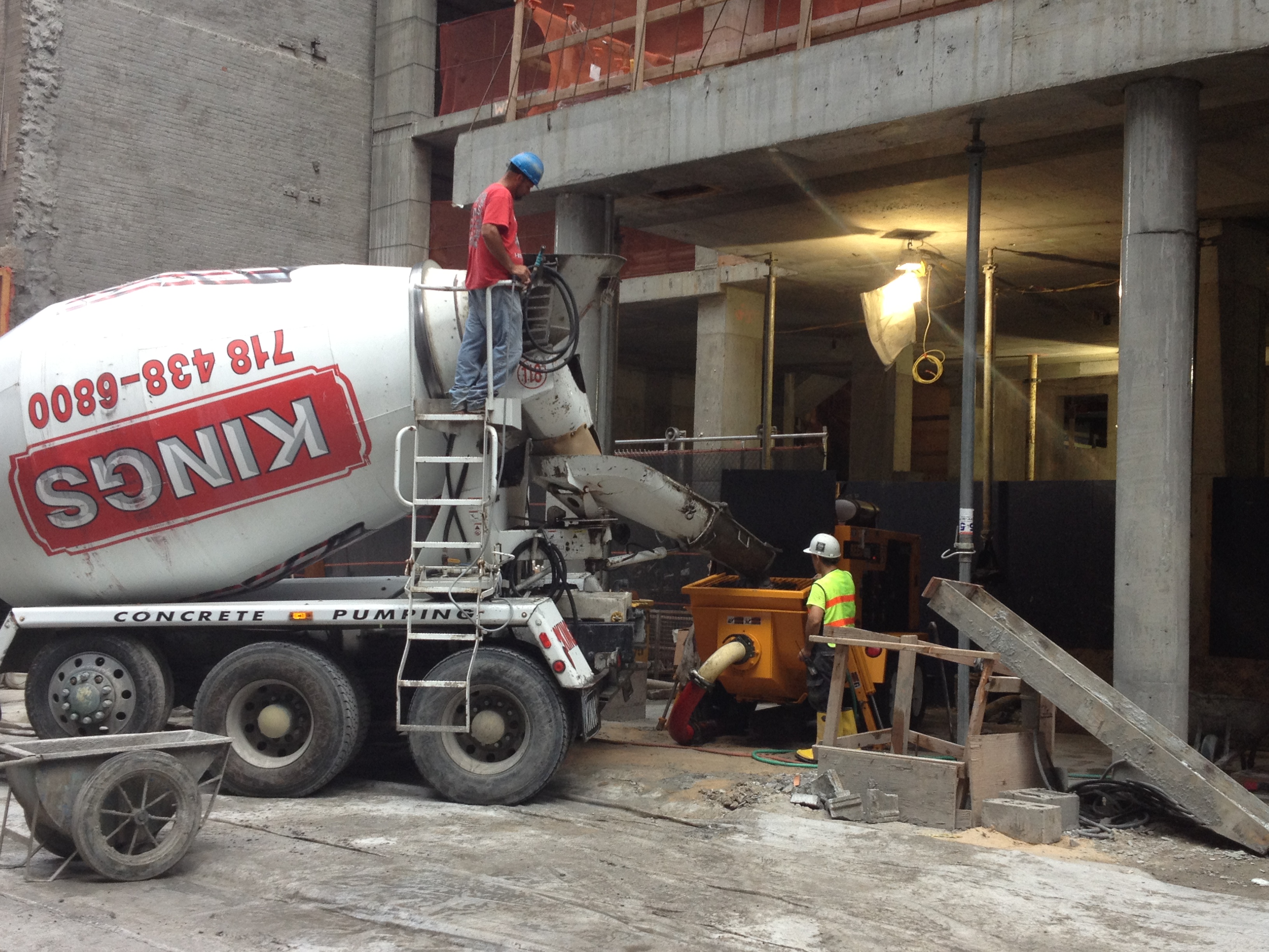

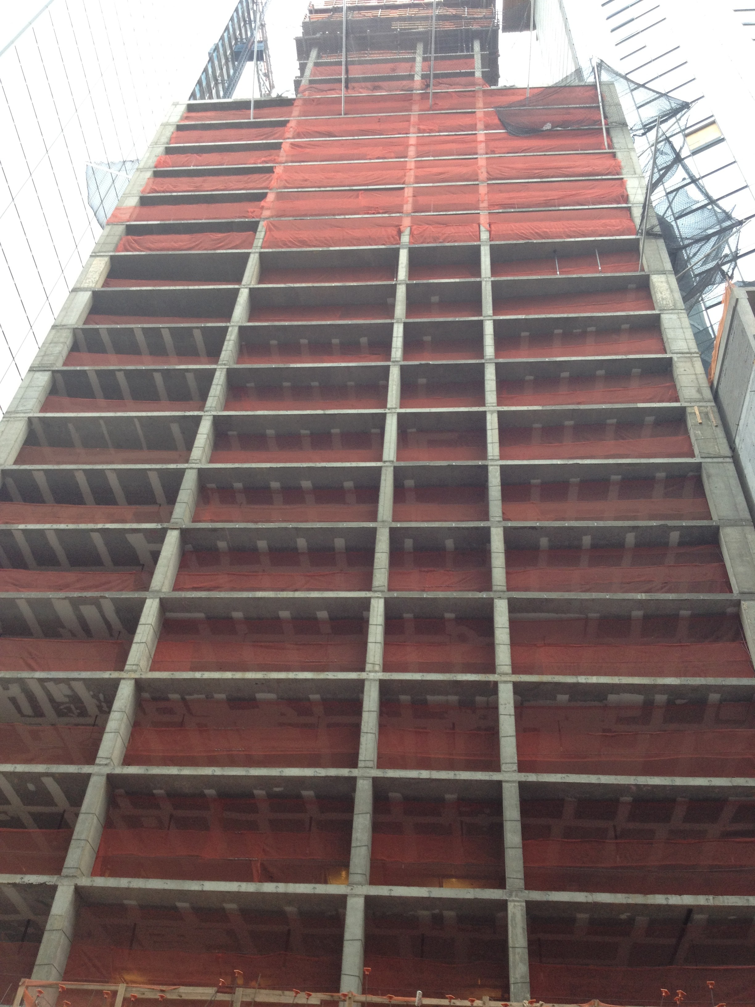

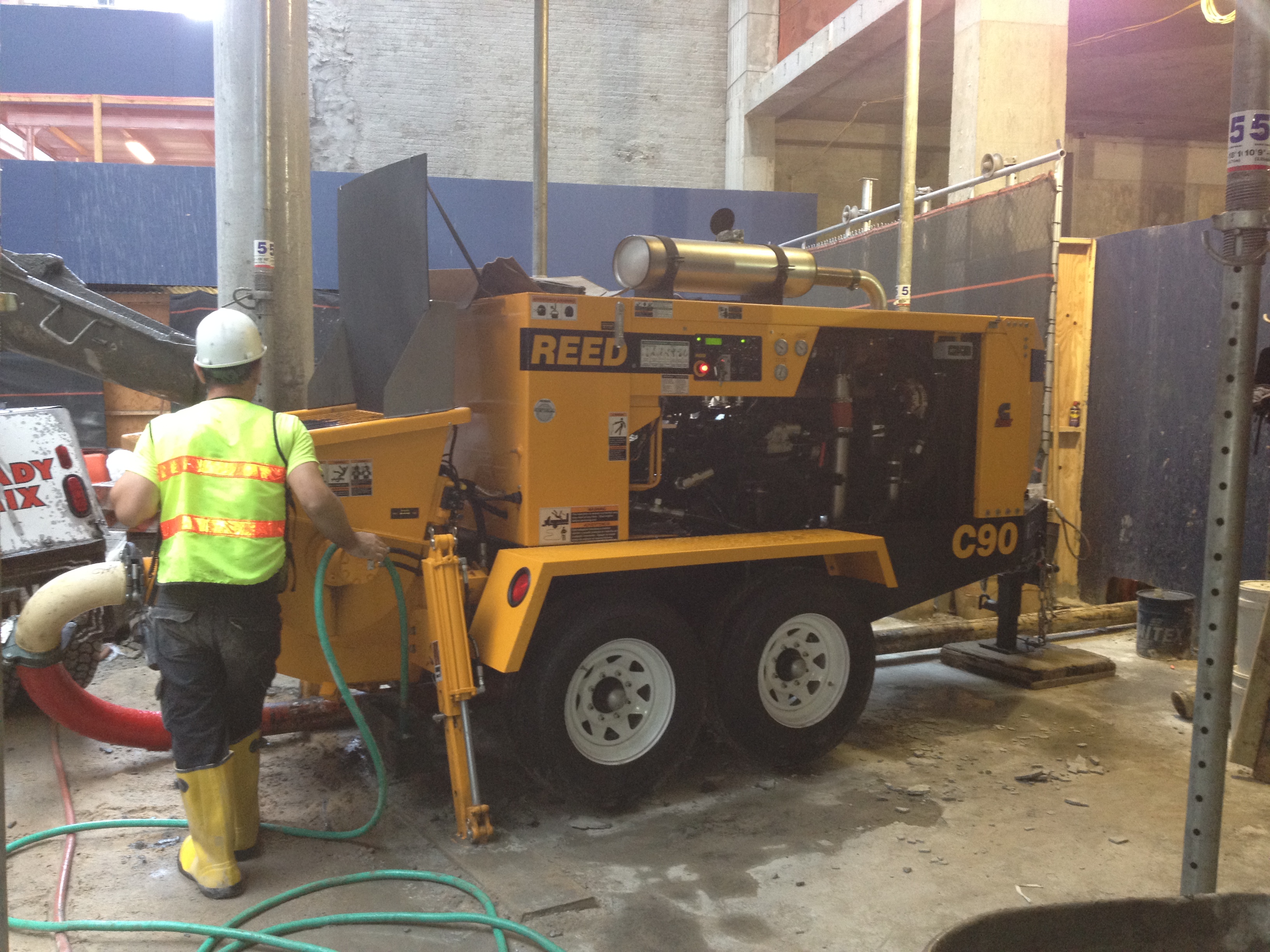

| REEDPumps | 03-05-2018 | reply profile send pm notify |
Thanks for posting that Logger! You guys are running C70S model pumps, correct? (powered by a 160hp Cummins 6 cylinder diesel - 7" material cylinders) We've actually got quite a few little REED Pumps doing vertical pumping in New York City, mostly B50/B70/C70SS/C90S model pumps. Customers in places like Russia, Nigeria, and Peru even use our little A40HP model pumps to do vertical pumping for smaller projects like apartments and shopping centers. I wish i had more photos!!! - Mike @ REED Pumps |
