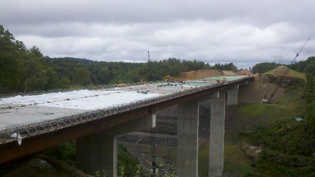

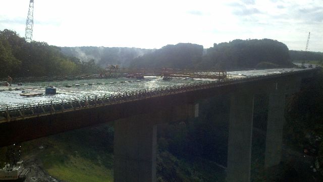

2ed pour, You can't hardly see the Line Dragons but there out there |

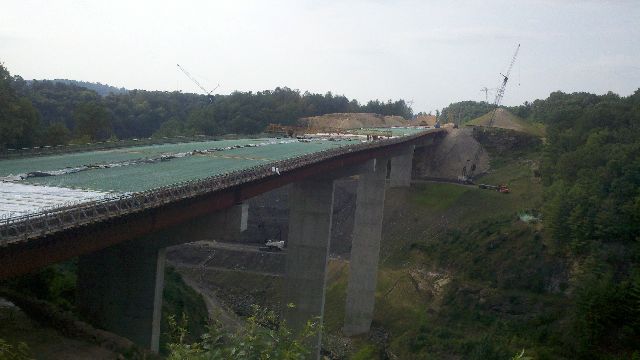

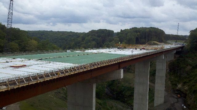

3rd pour |

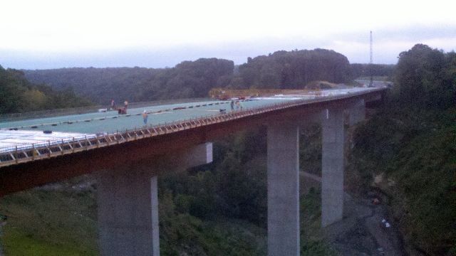

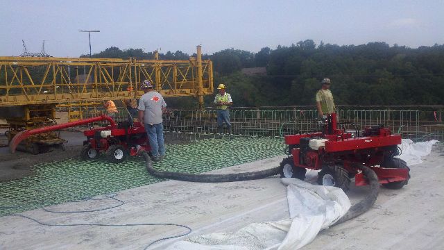

4th pour |

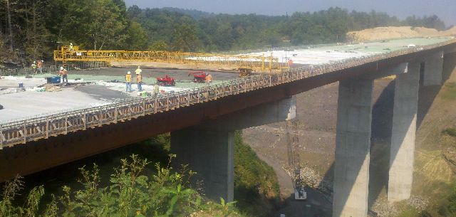

4th pour |

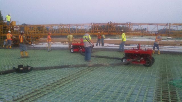

first pour on the flip side |

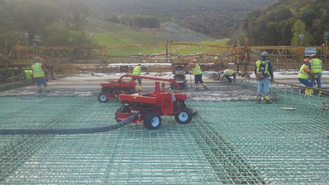

2ed pour on the flip side |

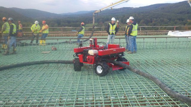

I see you also have some plastic 'Hose Sleds' to keep the clamps out of the rebar....pretty slick!! A lot easier than manhandling that heavy larger diameter hose. Maybe one guy with a hook to be a bit of a hose wrangler when it's more convenient than dropping the hose with the Dragon. |

Line dragons look like a lot of fun!! I wish I had them it might have saved those 3 disks in my back LOL

Pretty cool tank,these machines are proving themselves over and over again. Im sure the guys on the other side of the bridge dragging those hoses by hand were eye balling the line dragon wishing they had a set also |

There is definitely a technique to handling hose. You can bust your ass fighting with it, or you can figure out the easy way. Line Drgaons justr happen to be another easy way. |

It all about the $$$. This crew had 5 men pulling the hose, even if the labor only cost them $35 per hour, that's $175 per hour. If they can rent the Line Dragon from there local concrete pumper for $125 per hour ( that's more then most pumpers get for a trailer pump ) then why not.plus believe it or not these machines are faster and safer then dragging hose by hand.
If I can make $ renting a trailer pump out for $100 per hour then I should be able to with the Dragons. Yes they do take gas and maintenance and ect ect... I can run the dragons for 10 hours on 5 gallons of gas for $18.25 That's less then I would pay a labor of 1 hour. The line Dragons do not need workers comp, paid vacation, paid holidays, sick days, or unemployment.
We did one job where they had 5 men pulling 50 feet of 4 inch hose, they where placing between 10 to 15,000 sq in about 6 hours. We demoed the Line Dragons for them and started to do between 20 to 32,000 sq in the same time. The best pour on this job we did 27,000 Sq in 4.5 Hours.
I know there are crews out there that do line pours with 2 or 3 men and pour very fast, my hats off to them. I would still like to show them how easy and safe ( and just as fast ) the Line Dragons can do it

The plastic hose sleds are very nice, They seem to slide a lot easer and are easer to handle
