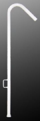

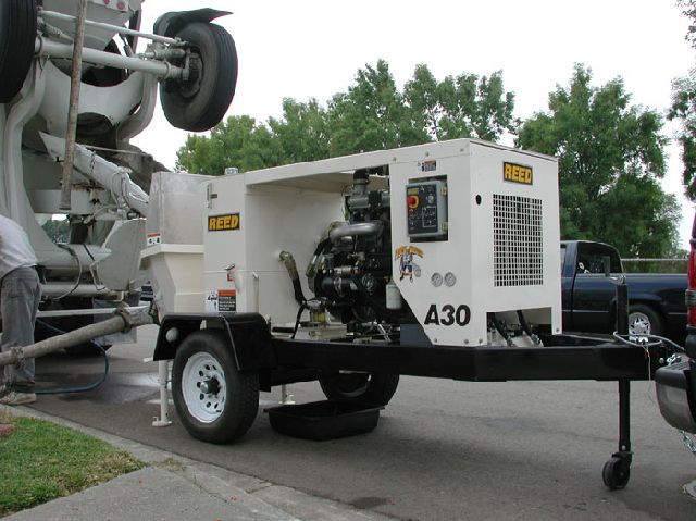

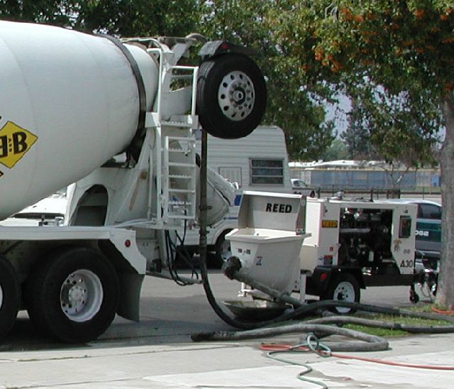

You need a 'washout hook' and learn to water wash the pump, the kiddie pool may be necessary too. Do a google search for concrete pump washout, lots of options will show up. (hint: change the google setting to images too)
| REEDPumps | 06-11-2010 | reply profile send pm notify |
here are a few pics of that washout hook he's talking about (not the best photos, but you get the idea). REED p/n 87307 - 2" washout hook REED p/n 87306 - 3" washout hook - Mike @ REED |

Wash out hooks are great!! They are definitely your friend.But Please do yourself a favor (and every one else around)Come up with a way to Chain the hook down to the truck,While you are washing out.As for stressing out I have figured out that it takes the better part of a year and a half before an operator (boom or otherwise) gets "comfortable" (I use that word loosely).There are a hundred different tricks you will learn as you need them.....Trust me!!! and if you have any questions this is a good place to look for answers!! |
