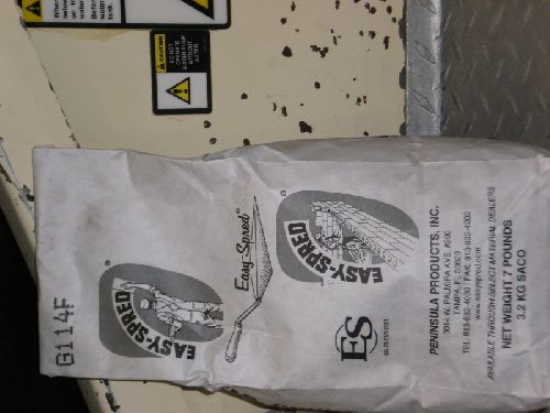

| thewizard | 11-21-2008 | reply profile send pm notify |
we use E-Z spread up here basically bentanite clay with some cement in the bag i think half of a 7lb bag makes 5 gallons of slurry, I usually go 5 gallons of slurry per 100'ish feet of hose 2'',3'',or 4''. great slimey stuff |
