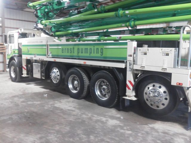

yes its 4.50 boom pipe having problems getting ball to come back first time ever running a z |

5 axles on a 40M? Why? |
| pumpin man | 01-04-2013 | reply profile send pm notify |
Im with Mike 5 axles???? Must be in Wa. |
| billdoe | 01-05-2013 | reply profile send pm notify |
ohio laws |
| thinksnow | 01-05-2013 | reply profile send pm notify |
NOTHING WRONG WITH 5 YOU AVOID ALOT OF OVERWEIGHT TICKETS AND PERMIT BS. |
