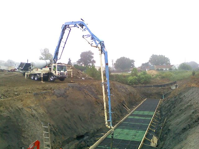

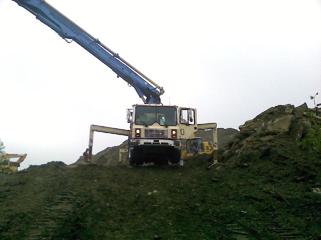

Haven't put anything up in a while, here's a little something. |

Nice pics. Mixer drivers love it when you have the truck parked in a little drop-off, so the hopper is nice and low. The mud runs so easily down the steeper chute then. Don't you just hate having to get into the cab after lifting the front end so high? |

Nice truck and work! Is that a 32 or 36? |

Thanks I try to keep it clean its a 1995 32M R&F truck is a 2002 |

don't know about other makes but schwing pump manuels say you shuold only jack front up until you see the weight just coming of the tyres the front tyres should never leave the ground.i wonder if that dynamic pump had its front wheels of the ground?not dising anyone here just seems to be a done thing but is it the correct way? |
| Vasa | 09-25-2010 | reply profile send pm notify |
If you stand on a flat surface , only lift the pumpfront enough to unload the spring but if you must lift it so you are within the 3 degree angle to have the pump in level lift it up . No problem on Putz or Schwing built on Volvo or Scania chassi . |
| mudcup | 09-25-2010 | reply profile send pm notify |
Yes the only reason I jacked it up that high is because I was on a downward slope and working down the slope with the boom it had to be done to get within 3 deg I would have thrown off my counter balance the pump is very sturdy when it's jacked up like that but I only do it when I have to. Thanks MATT I've been out pumping just no time to take pics |

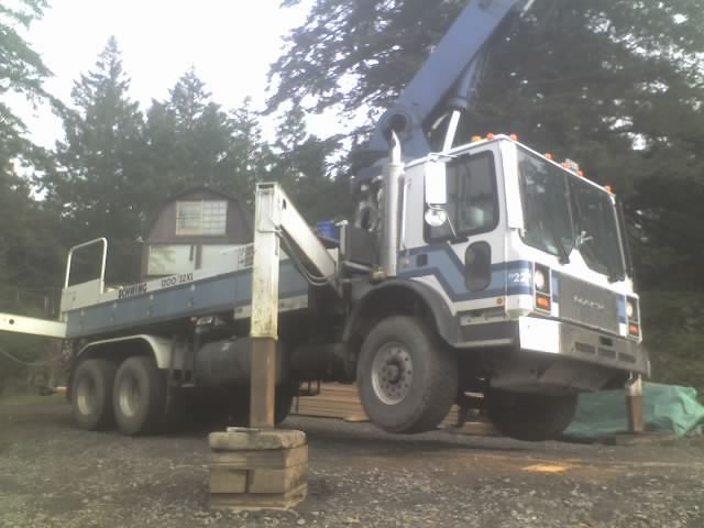

I run a schwing 32xl, very similiar to mudcups. I live and work on san juan island, lots of water front jobs. I have my front tires of the ground in order to get inside my 3 degrees quite often. She's as sturdy with them off the ground as with on. Never had a problem. |

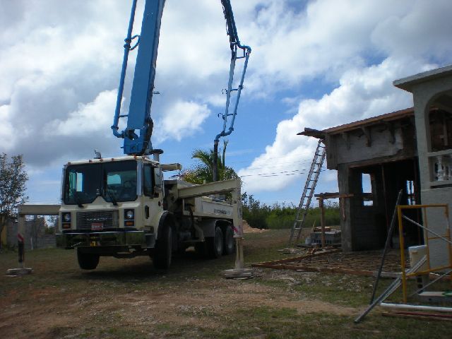

| chongliyan | 09-28-2010 | reply profile send pm notify |
| pumpjockey | 09-28-2010 | reply profile send pm notify |
Where's your rear outri.........just messin' with ya!! Your setup looks fine. Concrete roof I take it? They didn't bring you there for the slab on grade only, did they? |
| Many | 09-28-2010 | reply profile send pm notify |
thought I saw it in the grill sitting there,grin |
