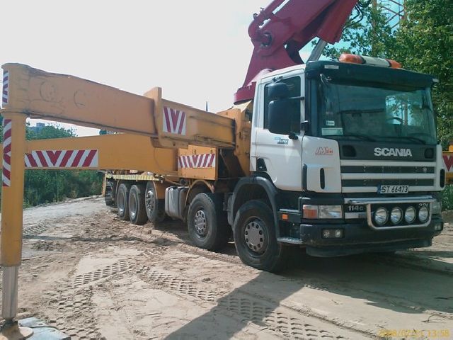

Dipstick like TooTall said is a Mission imposible. You need to known a simple rule: 10m of boom is c.a. 10t of CP(concrete pump) weight. If you want to buy a 42m pump, that pump really will have about 40t or more (with oil, water,1x operator,etc.). Better watch the laws in your country, surely this kind of vehicles may need special permissions. In the attached picture you may see a 10x4 truck who registered like 8x4 !!! (LOL) and have "legally" 31800Kg of weight.....
