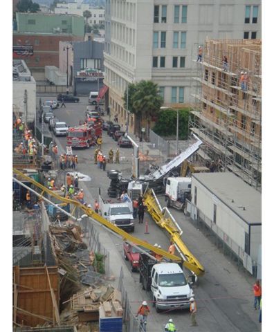

happened this morning dont have anymore details. |

I sure hope every one is OK.. And Please tell me this is not ANOTHER short rigging incident.. I can read and I know no more details are known at this time I am just sayin'.... |
| therealdeal | 06-29-2009 | reply profile send pm notify |
Yeap, another victim of shortrigging, happened Fri. morning. Nobody was hurt, maybe some egos. |
| pumpjockey | 06-29-2009 | reply profile send pm notify |
My first thought was: 70M, but there aren't enough axles. Some other trailer-boom Putz. 52M? 46m? Short-rigged for sure. Short-rigging is like fighting terrorism, the operator has to be right 100% of the time, 'cause gravity is always there, waiting to kick your ass!! |
52 tractor trailer. |
| biged | 06-29-2009 | reply profile send pm notify |
Why are so many booms getting flipped over this one looked to be on solid rigging why would anybody short rig on that size of pump. |
| bigstick | 06-29-2009 | reply profile send pm notify |
Total lack of experience, no excuse to ever turn over a pump on hard ground, bet the guy has been running this size pump less than three months. I've personally witnessed operators with less than six months experience operating fifty-two and above pumps. You Can't Fix Stupid. As long as owners allow this kind of shit to continue this will be the result. |

I am with you pumpjockey this will be a common occurrence for the next couple of years, I ran a 58 and its hard to shake me up and I am not scared of any size pump but I never would shortrig that pump just to much machine if you had a brain fart , it can happen to any of us thats why the good ones take precautions to see it doesnt happen, and yep the pipe manufacturers business will most definitely be on the rise for the coming years . There should be some kind of stipulations with experience before you can run one of these 52m + machines just to much for a greenhorn to handle without much experience |

I heard the operator was just setting up, had not even primed the boom. I saw other pictures I forget where thou, and nobody was hurt. Todd probably has better pics ! |

No, no one was hurt, but angels were setting on four shoulders. 52m short rig because of traffic going by in the lane to the right. Rig set up on the left next to curb. Both passenger side outriggers extended, both driver side outriggers out 12-15 degrees. Boom extended about 25 degrees off center of front to power side. Boom stopped short and rocked fully extended. Moved about 2 degrees further to the front and rolled right rear to left front. The picture shows the rest. |

You really think this guy is a great operator? Are you shitting me, if for some reason you ever have to shortrig a big overhead roll and fold pump you NEVER and did I say NEVER go past the extended pump side outrigger. There are diagrams on the side of the pump illustrating this, in your shop, and in the pump book. Even if a person cant read they can at least look at the pitcures. Dont want to sound too harsh, but when someone does something this stupid it makes our whole industry look bad. |

sorry tracy,your not the tracy i thought it was.and bigstick,he didnt go past the front outrigger on the pourside,the passenger side.a guy messes up once and all of a sudden he is a green horn has no experience and is and idiot.accidents are a part of life,just like the word it was an accident.yeah it was bad but it could of been alot worse.thank god it wasnt.and yes i ran a big boom for a long time,you dont have to tell me twice!i have been in some of the worst situations you can even imagine with just about any big boom size 52m+. you guys need to go a little lighter and find out facts first before you start name callin and company grindin.you see some pics and you are a osha investigator,i mean come on take a deep breath and see what surfaces from this.wheater you like it or not we all are in this together and do the same things,have a little respect guys! |
| Many | 07-02-2009 | reply profile send pm notify |
Should we ever get a chance to look at the video again,take a close look.I realize some here can't focus but look closely.Towards the begining of flip watch the top of the boom,it inches to the left (past point of no return).What the heck,missed that day in school? Balance 101. |

I have the video right in front of me and I look at it everytime I want to see something so scary that you wonder why, and then ask why again without an answer. The operator said it was because the contractor told him to set up that way. No the contractor didn't. The instructions were short rig it, we need the lane open. I would have expected the operator at that point to say based on the video, there is no way in hell I am going to short rig it. It just aint going to happen. Move me down so the driver side out riggers coult be out at least half way in the right direction pointing forward. Not with both of them facing backwards at a 12 degree angle. Whose had fault when it is set up that way. |

I HATE TO BE THE ONE TO PUT IT SO BOLDLY BUT THIS WAS OPERATOR ERROR ALL THE WAY!! THIS GUY WAS NOT SHORT RIGGED- HE WAS WHAT I CALL "HALF WINGED". IF HE WAS TRULY SHORT RIGGED THIS WOULD NOT HAVE HAPPENED. JUDGING BY THE VIDEO HE COULD HAVE TRULY SHORT RIGGED (WITH THE REAR RIGGER OPENED MORE ALSO) AND STILL SATISFIED THE CONTRACTOR WITH ALLOWING TRAFFIC TO PASS. THANK GOD NO ONE WAS HURT OR KILLED!! I MEAN IF THE CONTRACTOR TELLS US TO JUMP OFF A CLIFF !?!? RUNNING A BIG BOOM IN THIS POSITION (AS ALOT OF YOU KNOW) CAN BE DONE (ALLEY SET-UPS OBSTRUCTIONS ECT.) BUT YOU HAVE TO KNOW THE BOOM NEVER GOES PAST THE FRONT OR REAR OUTRIGGER. IN REFERENCE TO MEMBER SINCE 1969 IF YOU CALL THIS GUY A "GREAT OPERATOR" I'D HATE TO SEE OR BE NEAR WHAT YOU CONSIDER A BAD ONE. |
