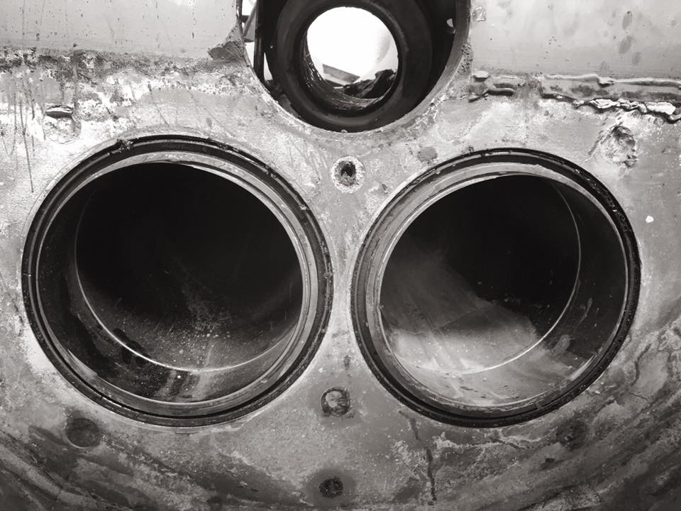

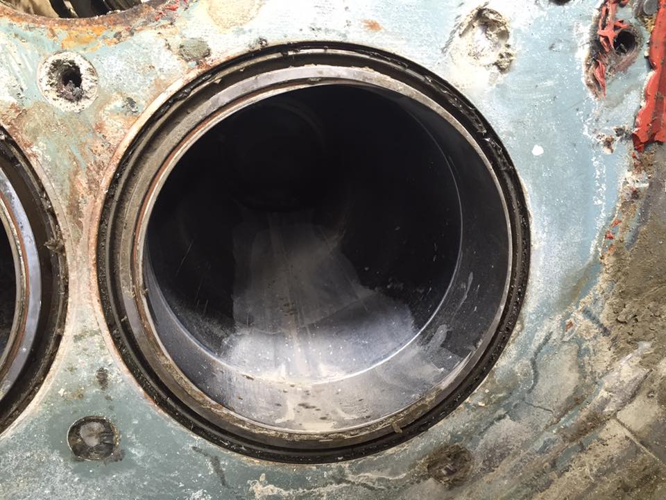

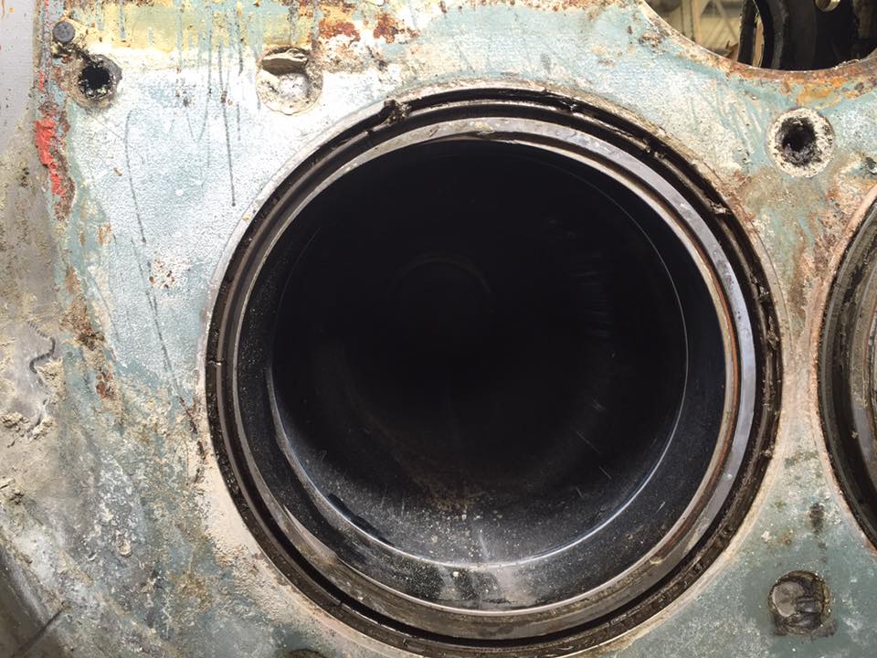

Hey just wondering if people could share their thoughts/explain why this might be happening, uneven wear on the reduction cones.
| Todd | 01-28-2016 | comment profile send pm notify |
This is a Sermac Pump |
| PumPro | 01-28-2016 | reply profile send pm notify |
Looks like the S-tube is swinging over to far. have a look at the cutting ring to see if it is showing more wear on one side. This will usually happens on the same side because the s-tube shift cyl's are out of adjustment. |
