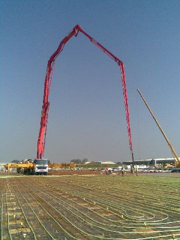

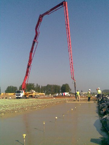

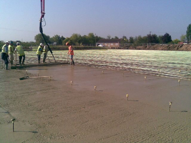

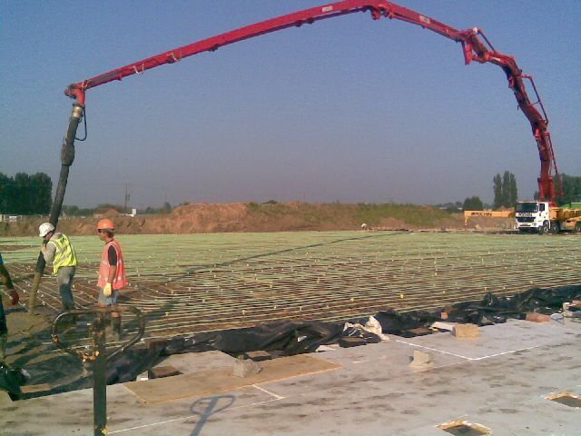

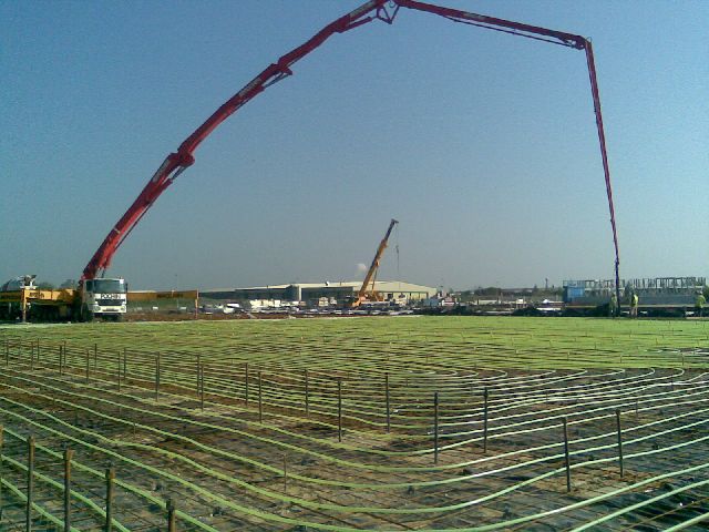

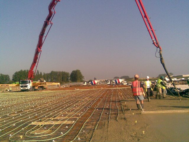

thats alot of slab. i seen your pics from another slab and you were running the boom Z instead of A frame. other then more joystick work, do you find there any difference. had a 55m jun-jin with the same boom setup and found that Z is the way to go for SOG. still think thats the best big boom configuration out there. |

nice |

Wow,that's all I can say.I'v done driveways,inside houses but that's just huge.Nice job pic's |

I found that z fold is brilliant depending on how fast the gang are running around the slab it's quicker with the z fold. I've also found that with the boom in EBC on manual it's super smooth just depends on the job that day which one i use. . I love the pump tho it's so user friendly. |
