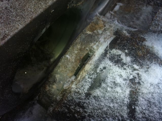

had to replace s.valve big hole all around the top and it was like paper only noticed it when my operator cleaned concrete form around the cutting ring |

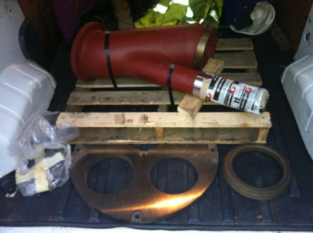

fare play to con forms uk they opened early saturday morning so I could pick parts up, dave edwards @ conform great guy |
| Todd | 02-08-2012 | reply profile send pm notify |
wow great stuff, thanks for posting it. Conforms is a great company, good bunch of guys for sure. |

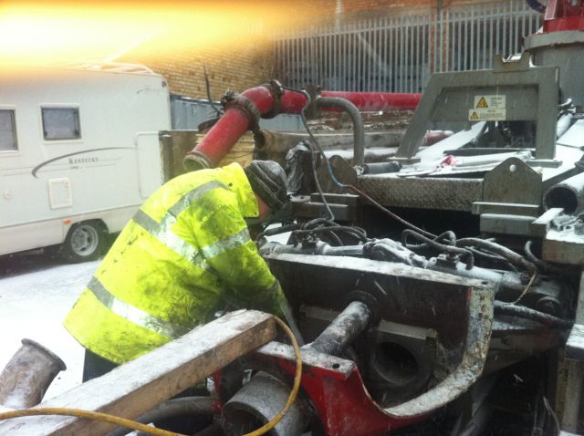

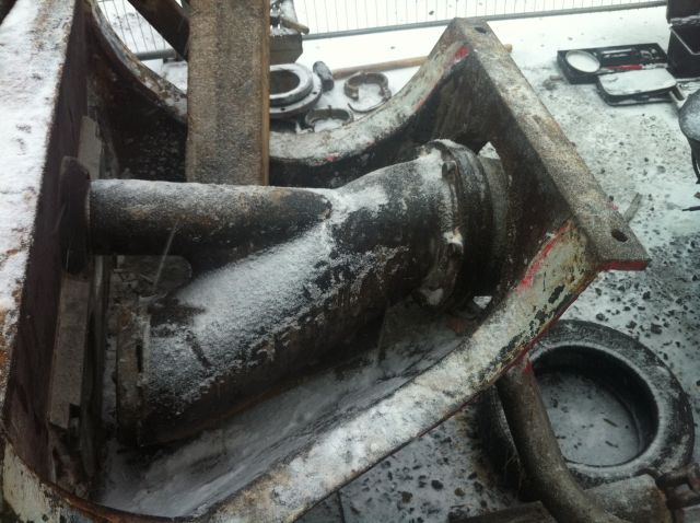

Nice photo's. I had to do that same operation on my 305 s tube line pump a few times. But its only a 5" S tube. Its good to get it apart once a year to check it all out. On mine the rear grease bushing was bad and the tube was rocking. I bet that s tube weighed a few pounds. |
| any pump 2 | 02-08-2012 | reply profile send pm notify |

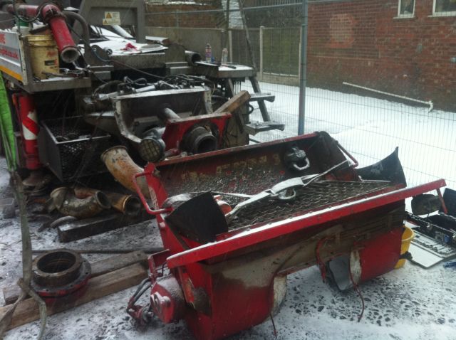

it was a complete bitch to do. you got to take every thing of the back ,even the bush housing. there is only couple of mil to play with . ive done a few on putzmeisters there easy compared to sermac . the new one is extra hard wearing so dont think ill ear it out. the company that had the pump before me must of been pumping grinding disks to wear it out like it had. its only done 1300 hours |
| SUPERDOFFER | 02-08-2012 | reply profile send pm notify |

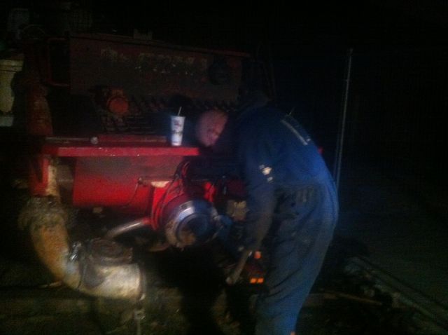

A bad thing to do out in the open. Whe did a wear part job on a schwing 34sx I once operated inside by 6 degrees c the heater lost the fight whit the outside temp of -15 |
| b-alto | 02-08-2012 | reply profile send pm notify |
Yeah it sucks working in the cold by yourself. A warm shop and a fork lift would have been nice. I finally built a shop last year and love it. Being able to tear apart the ass end and rebuild, is essential when owning a pump. (you obviously are mechanical).PS: Oh i just realised this is your new pump. Nice unit just takes a while to get them up to par. |
