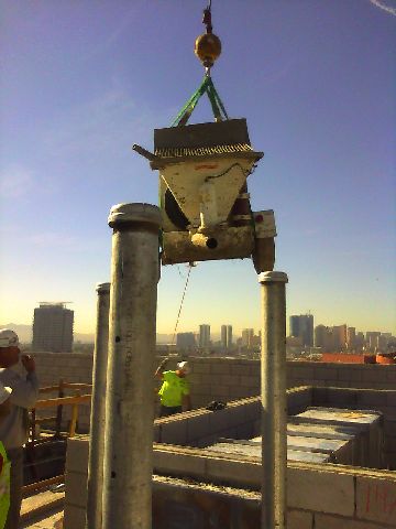

| typesdubs | 03-17-2010 | reply profile send pm notify |
Why pump into the other pump? |

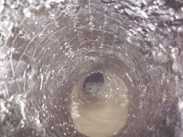

| pumpjockey | 03-17-2010 | reply profile send pm notify |
The reason for pumping into a smaller pump from the boom, is that if you reduce down to 2" hose out of the boom pump and spend any amount of time pumping slowly (as you would doing blockfill), the concrete valve and eventually a lot of the downstream piping will get a build-up of 'dead mud' that matches the diameter of the smallest sytem connected. Not a good thing to have to deal with. It may end up packing on the mud cups too. |

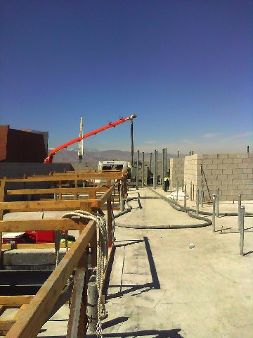

| oregonfan6285 | 03-18-2010 | reply profile send pm notify |
ok i was pumping at a 0 on the 61 meter. i try not to hurt any one. i want you guy to pump at a 0 with 2 inch line on a 61 meter and tell me how the hose man feels after the pour. the grout pump storkes like four times as fast and alot less surge in the hose but what do i know i guess. |
| hammah | 03-18-2010 | reply profile send pm notify |
Ahhh Richie dont beat yourself up man you did the job thats all that matters. And their are diffrent strokes for diffrent folks lol so if the hose man was happy then i guess its a job well done. The wall looked small too for that 61 meter looked like you would be turning the pump off and on or the guys running the hose would have to move faster. Maybe if the walls were biger i would prefer running the hose of the boom but thats just me i like them long strokes ahahahaha. |

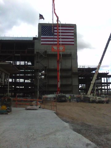

| 16 CELL | 03-19-2010 | reply profile send pm notify |
there was, at one point an article on Putzmeisters website in which there was a long/slow continuous pour (slip-form Silo I believe) where they had a TK50 trailer pump plugged into the deck pipe of a 63M pump, in order to avoid the hopper/swing tube buildup that you guys are talking about... unfortunately I can no longer find it on their site (was in the "job stories" section), I would have liked to post the link, it was a really cool article!, anyone else see that one? |
FOUND IT-Gordy’s team pumped the concrete mix for the chimney up to the 180-ft. level with a combination of their mighty Putzmeister 63Z-Meter concrete boom pump and the TK 50. “Bringing the 63Z-Meter and the TK 50 together was somewhat of a pioneering adventure for Gordy’s over the past few years,” comments Salmon. “With the two units working together, we were able to pump 24 hours a day and complete the first part of the chimney in just nine days.”
The units were perfectly matched for this project; the 63Z-Meter provided the reach the project required, while the TK 50 provided its smooth and reliable pumping. “Putzmeister machines have not only proven they are powerful as independent units,” Salmon says, “but they are even stronger and more impactful when working together.”
While the Oak Creek Power Plant expansion was Gordy’s first time using the TK 50 and the 63Z-Meter in unison, Gordy’s used a similar combination of a large 55-meter truck-mounted boom pump and a TK 50 on a feed mill tower in Milton, Wisconsin in 2004. “The pairing enables the slip-form pour to run smoothly without interruption of concrete placement,” notes Walters.
To handle the challenging height of the Oak Creek chimney, the TK 50 pumped the concrete directly into the delivery line of the 63Z-Meter which then placed the concrete up to the 180-ft. level. The slip-form on the chimney played a huge part in why Gordy’s chose to use both Putzmeister units together. “Because the slip-form rises at a slow and consistent rate of less than one foot per hour and the concrete curing time is needed, the TK 50 had to pump the concrete at the same slow rate of seven yards per hour,” Salmon comments. The TK 50 kept the tough mix continually moving to avoid any buildup while pumping.
“Had we used the 63Z-Meter alone for pumping the 1,500 cu. yds. at such a slow pace with a mix that set up so quickly, our placement team would have had to frequently remove buildup of the concrete that would occur, and would not have been able to pump round-the-clock,” says Walters. “The powerful pump on the 63Z-Meter is meant for high pressure or high volume. By combining it with the TK 50, we were able to capitalize on the benefits of each model to pump the small volume of concrete consistently at the slow rate the project required while easily reaching the point of placement.”

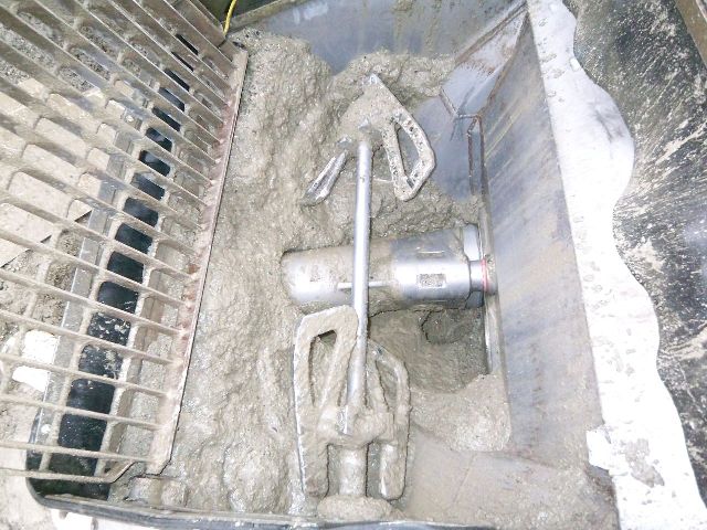

| 16 CELL | 03-20-2010 | reply profile send pm notify |
we occasionally do shotcrete with our boom pumps, and the hopper generally looks something like this at the end of the day.... fortunately we carry a chipping gun small enough to fit inside the S-tube and bang out the buildup... |

im with mr wibau on this we do 50 , 60+ cubic metres of block fill with s tubes and 36m booms and you get a good fit on the cutting ring no problems hard facing the s tube wouldnt help either |
| 16 CELL | 03-22-2010 | reply profile send pm notify |
agreed, the hard faced S-tube seems much more prone to buildup |
