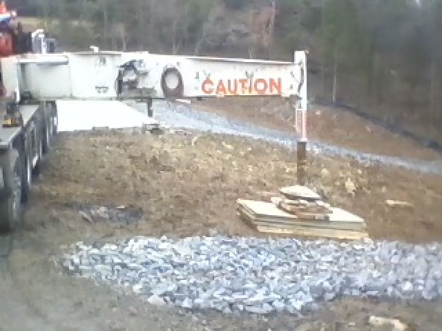

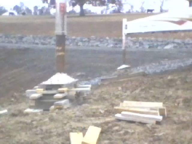

Took me 2 hours 2 set up on this job. Tried with every pad I had on the 61m. A stack of 2x4 I had them cut up and a pallet of plywood (c 2nd pic) didnt like how it was set up still and sent them 2 town to get a truck load of 4x4s. (we were way out in the sticks)And 2 really top off my day I got stuck gettin out! Took a very large tow truck and a huge trackhoe they brought in from the tow company. 22 hr day in all. |

Ya these pics were b4 I sent them 2 get the 4x4s by the way. And I was over the right front sticked out, Then it started pouring rain thats y I had to get the wrecker and trackhoe. It almost rolled down that hill when I tried 2 back out. SCARY SHIT!! |
