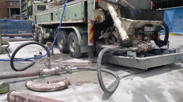

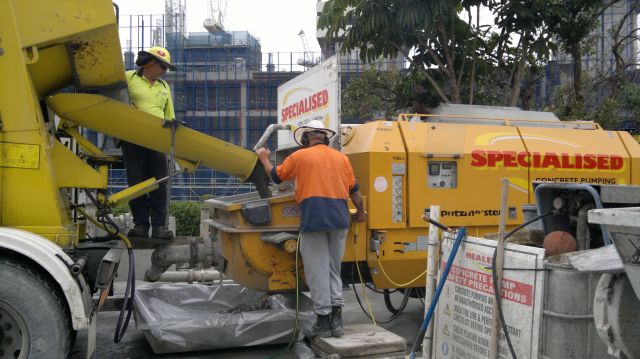

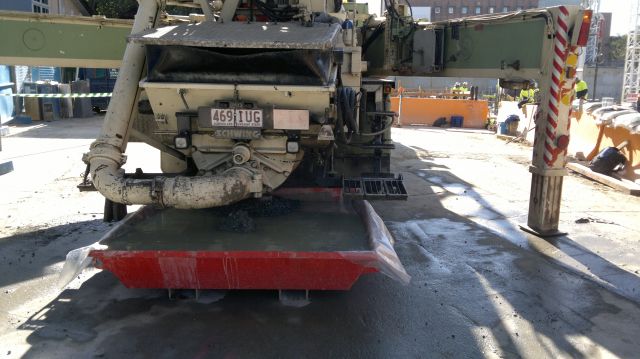

Hi pumpSHEP Don’t have any pics of ones with wheels on, first tray use to have wind down jockey wheels but due to the weight when full I think they broke, we provide a tray with all of our stationary pumps and use a pallet jack, forklift or site crane to move around and empty, and on mobile pumps if there is no tray it is sugared up and back to recycle plant or yard.

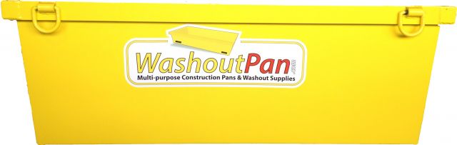

We've been buying rather than renting and it's saving us a ton. It's also cheaper than making your own. |
