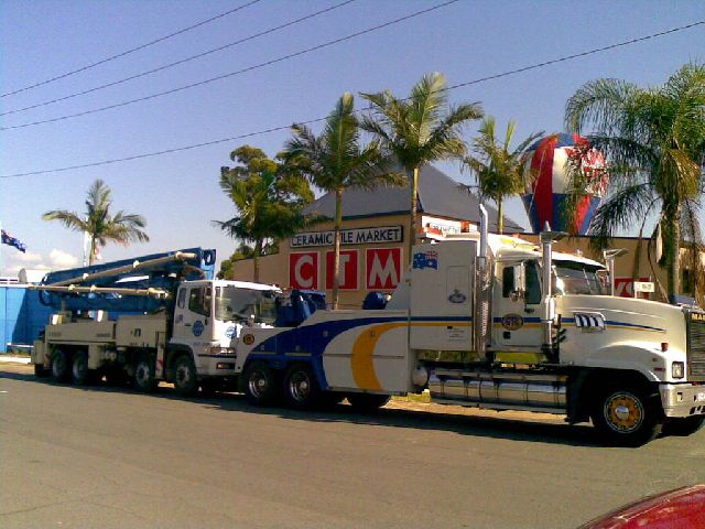

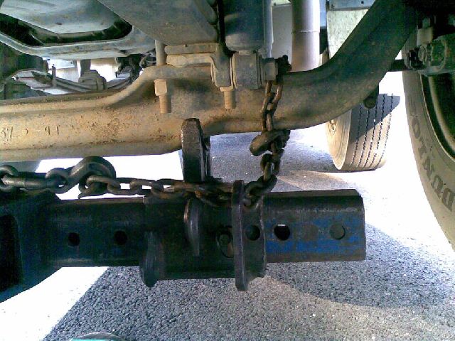

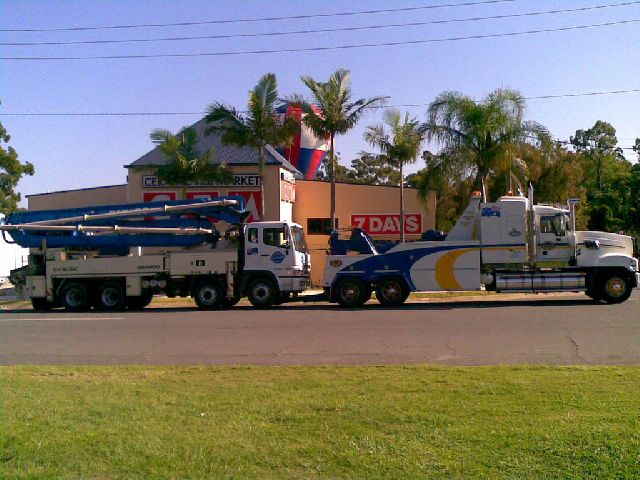

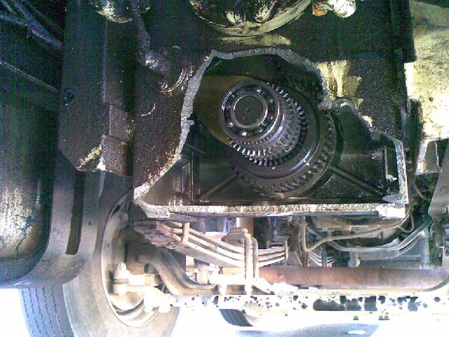

Customer rung up this morning saying that his concrete pump had lost its PTO. I thought he was joking till i arrived on the scene. The best bit was he made the driver remove the drive shaft for me so all i had to do was hook up and supply it with air and tow back to his yard. |

It looks like it has recently been worked on by the sludge being scraped off by the fill hole,oopps,forgot to put the plug in. |

Good case in point for stepping up maintainance procedures. The box although typically dirty on outside may not have had anything to do with outcome, however the output side driveline coming apart at speed most likely left what can be visualized as a "wrecking bar" beating its way about the back side of the box, the terrific leverage and offset weight literally tore the output support bearing housing and casting apart. The costs of upkeep on some "U" joints, or a slip joint pale in comparison to a new box replacement. The old adage, pay me now, or pay me more later. |

In the first pic did anyone see anything odd.There absolutely no indication of lubricants dripping from anything.I find it strange sinse it's already on the hook leaning back that nothing is leaking and on the ground,mmm |
