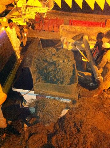

WE have a pipe line 5.5'' with 80 m height recently we have a problem in sucking the ball while cleaning the line i doubt in ruber seal but it is very diffcult to reach the pipe line because of the site is complicated.and also may be it is the concrete i thaught that is the slump is less and there is a proplem in the mix the setting time is to small even we are using superplactiziser .so we are using water in the pump to clean the pipes every time and it is working nice.later we found the site became like sea because of the water so we are not allowed now to use the water any more.we tried today the comppresed air and it was good but the problem it is very dangrous may be the ball will hit somone specialy we are working in main loby for a hotel so any one has ideas about the safty of using the air? |
