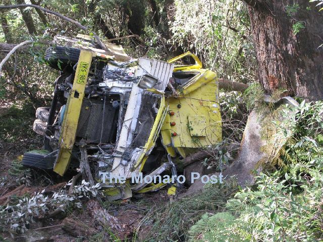

Bermagui man, Christopher Reid, is lucky to be alive after the 24.5 tonne concrete pumping truck he was driving lost its brakes and careered off the side of Brown Mountain last Friday afternoon.
The truck, owned by TCR Concrete Pumping, was being driven back to the coast after a day’s work in Jindabyne.
The accident happened at about 2pm on Friday, 500 metres past Pipers Lookout.
Mr Reid lost brakes and steering for about 500m before the truck rolled on its side and then travelled through the guard-rail, ending up 35m off the edge of the road.
Mr Reid was able to walk away from the accident, with some bruising and a gash on his head. He was able to ring his brother and partner, Tim, to advise of the accident.

The truck will be retrieved this week, but it is expected to be cut into about five pieces to be moved.
