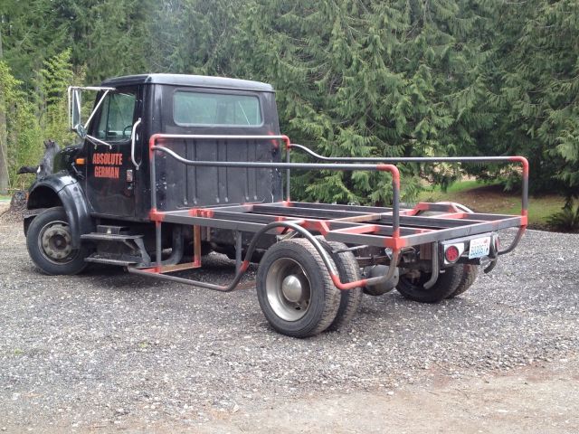

Progress |

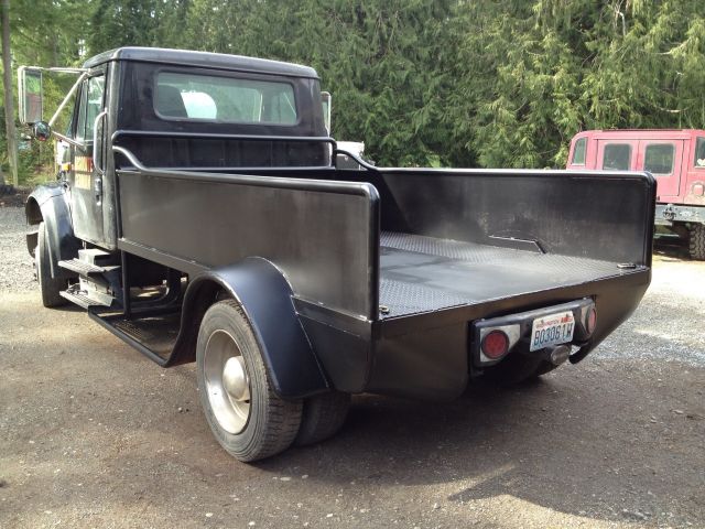

More |

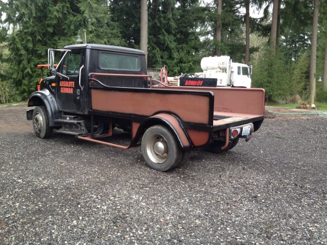

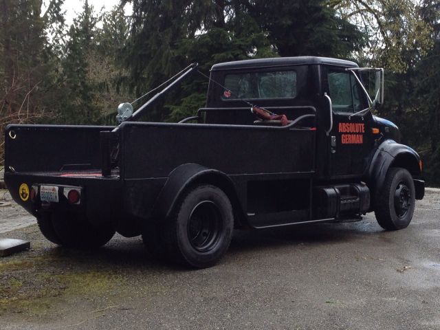

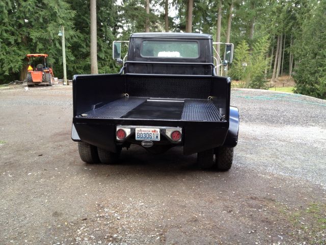

I built it so that I can cut out the taillight area and top sheet metal and slide a pump in there, it's all 3/16 and 14 gauge, bed length is 10' and 6'2" wide, I put a little removable tube hoist in it as well, fun truck to beat around in, with new used tires, I have exactly $2750. In it including price of truck, one week to build, still needs running boards fabbed, but squint your eyes and you can see it |

Nice fabrication work! Are you mounting the trailer onto the truck (one unit) or are you going to tow it behind it? |

Pump is meant to mount in it |

Thats a fine fab job. i wouldnt mind have that to pull my tk 40. your work there puts me to thinking............ |

Your TK would fit right in the back |
