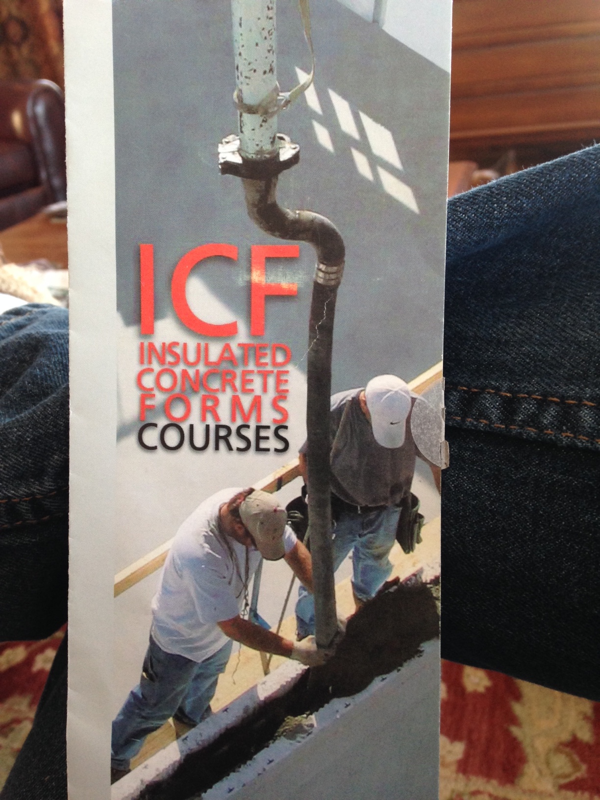

Ed i was talking about using the boom pump. People do not want to drag hose if a boom is available. Here is what i was thinking but reducing 5-3" elbow then 3" 90. |

Tip section 5 to 4 reducing 90 into 4 to 3 reducing 90 into a 3 to 2.5 straight then 2.5 placing hose ? |

I have used a 5-3 reducing 90 with a 3-2 1/2" reducer with a 2 1/2" mudsnake. |

Another option im considering is a 5-3 straight reducer with a 3 inch non ended tip hose. maybe with a throttle in the end of it or choke. No metal exposed of course.. |

I charge the same rate for my telebelt as my trailer pump. I guess let the customer decide. Belts work well for ICF's jusr neck down the hose. |
