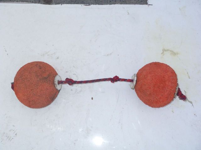

suck back on of these nice and slow (25% VOLUME) using a few litres of water between sponges, listen to the tip elbow as the sponges go back, once you can hear an echo as the machine changes strokes you're golden, the sponges will be sitting in the transition door everytime. I like the diesel idea, definitely going to give it a try. |

Hey 16 cell I like those balls we have the same of course, But I use a damp 8x8 never had an issue pulling slow, two if hot stiff mud though, eat one who cares hehe. But not that often. Butch loves them Fank seems to also, don't buy of build to many we have a dozen not used. |

we pay less than $20 for a 5" round sponge, around $5 for a 8X8 square. the round sponges (because they are rubberized) last about a year, and are much quicker/easier to clean than the squares. Square sponges last about a month, at best.... in our application. |

16 cell ,What hardness of balls do you use ? soft, medium, hard, what works the best ? |

Hard ball allways clean best....most preassure to the inside of the tube - but most work to get it into the tube. |

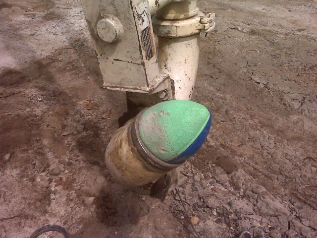

http://www.youtube.com/watch?v=Q2uxlhE7mOQ&context=C33f6af2ADOEgsToPDskLkfPK3Q917mo3N_fggIxid
this is how i do it clean as a whisle. |

I prefer the ones from Putz that come packaged in a clear plastic bag, I would call them a "medium" hardness. |

we drive with concrete in the hopper practically every day. but in this case the concrete in the hopper is washed-out because of the 100 liters water i mixed in it sucking the ball. i hope you enjoyed the video thow. |
