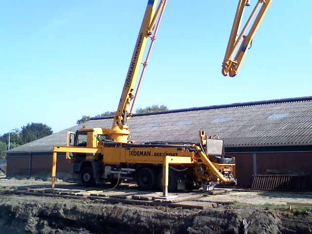

| Mr wibau | 04-21-2010 | reply profile send pm notify |
this 2ic doing his thing on a 37jj. now tell me the guys that say if it is going to go it will go either way, well what would have happened if the pads where only used. i am with 2ic all the way potty mouth or not, well at least with us using all our timbes if somthing happens we can sleep at night thinking there is nothing more we can do and not gee if i had timbers under that pad would this of happened.
fine before i put crete through.
also forgot to say i was there on the yellow foot being 2ic's line hand and that there where 4 more timbers under all that, that you cant see. |
all i can say is putting to many timbers down will not hurt and pads on there on a point less. also 2ic you are a great teacher thanks for teaching me to keep the tyre side down. even on concrete you can never be to sure.

THE OBJECT OF DUNNAGE IS TO MAKE YOUR FOOTPRINT LARGER, TO DECREASE THE PSI ON THE GROUND ON WHICH YOU ARE SETTING,JUST STACKING UP WOOD WITHOUT INCREASING YOUR FOOTPRINT IS USELESS IN MOST CASES,I SEE SOME PICS WHERE THE SAME SQUARE INCHES IS BEING COVERED JUST STACKIN WOOD NOT DOIN A WHOLE LOTTA GOOD,I DO BELIEVE SOME OF THESE ORGANIZATIONS SUCH AS ACPA,CPMA SHOULD HAVE DUNNAGE CLASSES TO TEACH PROPER DUNNAGE TECHNIQUES.AND FOR THOSE THAT SAY SHE WAS GOIN NO MATTER WHAT (I WAS ONE) WE NEVER WILL TRULY KNOW BECAUSE DUNNAGE WAS NOT DEPLOYED SO WE ARE GUESSING,AND FOR THOSE SAYING IT WOULD NOT HAVE WE DO NOT KNOW THIS AGAIN BECAUSE IT WAS NOT USED,NO ONE COULD SAY MUCH IF IT WAS USED THE OPERATOR HAD DONE EVERYTHING IN HIS POWER TO AVOID A CATASTROPHE NOT KNOWING WHAT WAS UNDERGROUND. |

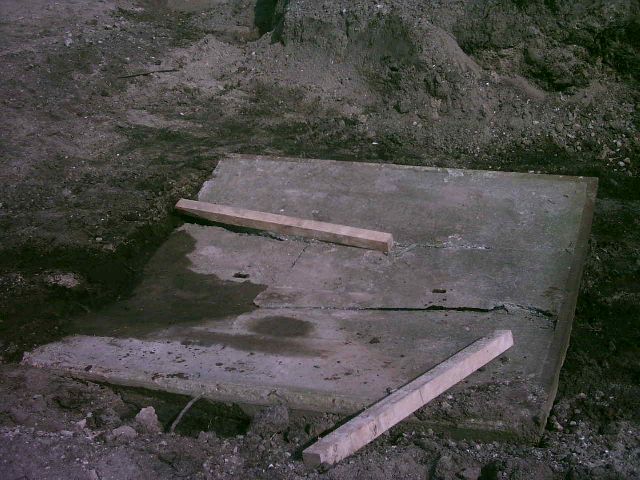

setting up on concrete is not always a smart thing. you can`t tell how its reinforced. for example!! |
| SUPERDOFFER | 04-21-2010 | reply profile send pm notify |
Or an other one the choice between,setting up allriggers out on un nowwen underound or short riggen on cranemats. give me the cranmats. |
And yes cranmats cane solve all your problems under this cranemat is nothing but clean air. |
