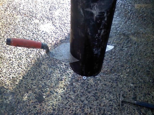

Drew AUS 05-12-2010
lol we dont have those round here! All we do is kink the hose ,  never have a problem ......
