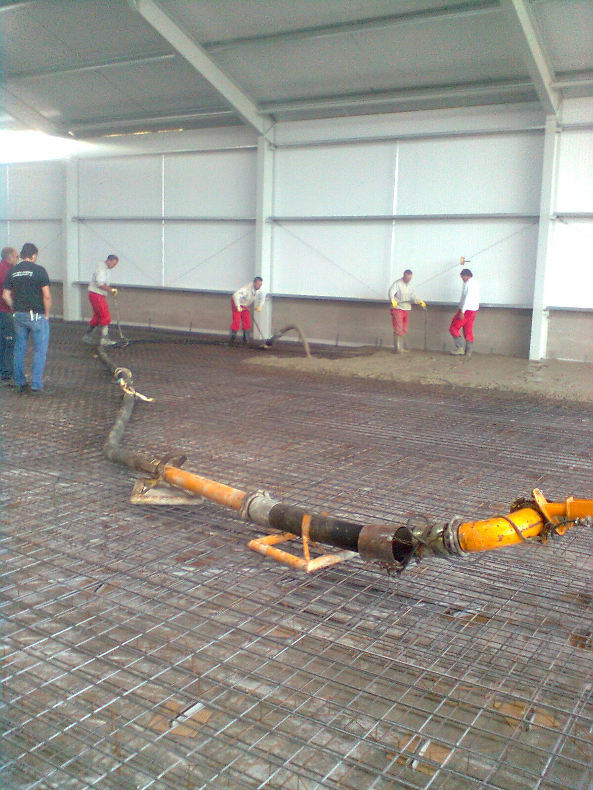

| hosecuffgirl | 04-04-2016 | reply profile send pm notify |
Don't get either, get a hose cuff |
| SUPERDOFFER | 04-05-2016 | reply profile send pm notify |
The best solution is a 1 meter dubbelender whit an hosecuf. And then you can hookon whatever you want. In Europe they are busy whit shutof systems for two decades already and I have seen solutions come and go but the hosecuf is the only one that survive in a dayly use |
Oh and BTW blade valves don't work whit fibers |
