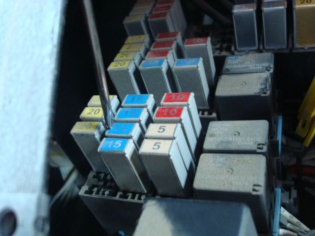

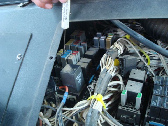

This is why I might need the serial Number for your unit. In the Mid to late 90's to 2000's this is the location of the PTO Fuse I dont want to send you on a goose chase if you have a unit that is wired diferently, but if you have this style of fuse pannel this might be your fuse, I am pointing at the 15 Amp breaker you might have to look real close there might be a small Push in automotive fuse in there, this is ok, they were prefering the fuse over the breaker anyway so just replace it if it is blown, NO BIGGER than 15 AMP.

This is just a closer shot of the same Fuse/ Breaker For the rest of you reading this it is good to locate this fuse and MARK IT!!!!!!!! Finding this fuse in a panic in the dark while concrete is arriving is not a good time. It is normal to find the Breaker has been replaced with a 15 Amp Mini Fuse, this is ok and actualy preferable to the breaker. To be sure you have the correct fuse you can AT THS SHOP, shift the unit in and out of PTO, Remove the fuse and you should loose PTO replace the fuse and now you are sure you have it correct. Never pull the fuse under load, Take the unit out of PTO then pull the fuse. If you are not sure turn off the Mack. Simple things like this can save a lot of aggravation on site, be safe and carry spare fuses. |
