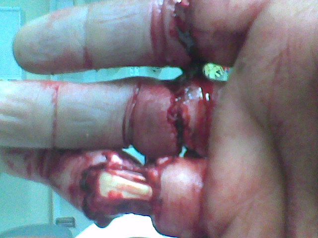

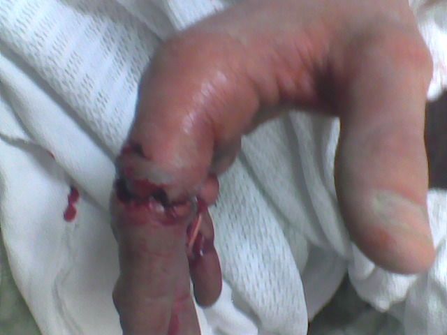

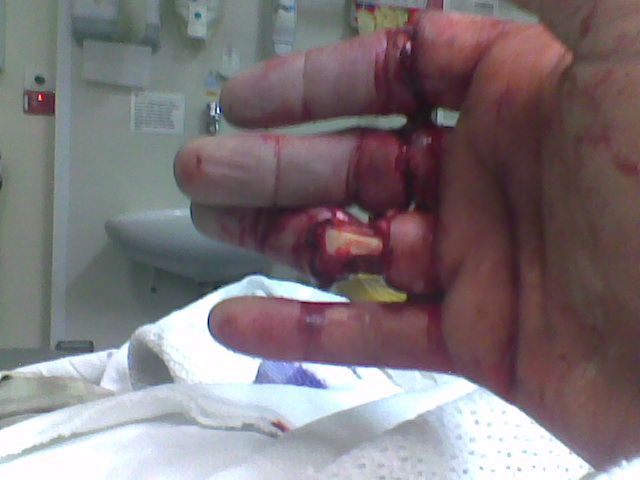

Here are the pictures of the busted up fingers

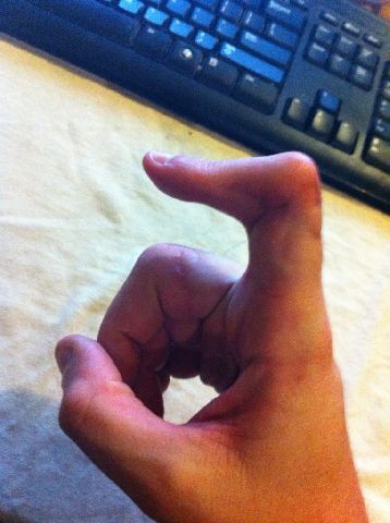

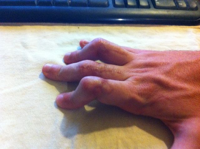

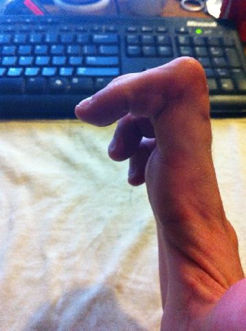

Here some pictures of the healing fingers.
