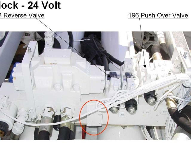

Have you fixed your pump yet? I hope so. If not Please check the Charge pressure on the test port M2/5 Depending on the version you have this port might be on the side of the pump or mounted up where all the ports are located centrally. With the unit in PYO at full RPM you should be reading 34 Bar, if you have 2 main pumps check them both. The control pressure is supplied from the charge pump to operate, no charge pressure no pump. Another thing to try is to turn on the pump and push the POH valve in and hold it, if it strokes with the POH in then there is a 1.2 orifice plugged. This orifice is located in the base block under a rectangle plate with 4 Allen screws, there are 4 o-rings and in one of the ports is a Allen plug that is the orifice remove it and clean reinstall. |
| Travelteck | 09-15-2012 | reply profile send pm notify |
The orifice is under the block circled in red. POH is #196 on right |
