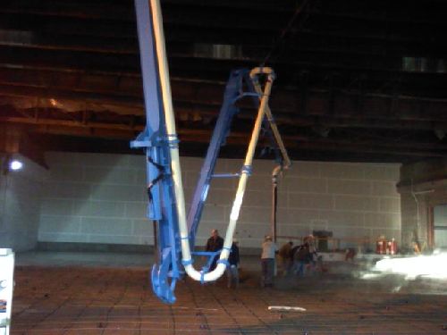

| elkhunterz | 01-16-2009 | reply profile send pm notify |
Here is a 28Z putz I set up inside a building in Billings, Mt. We had a 16 foot door and 22 ft ceiling. Poured out 160 yards and had to move one time to reach, then out the door. could have never done it with a roll and fold. |
