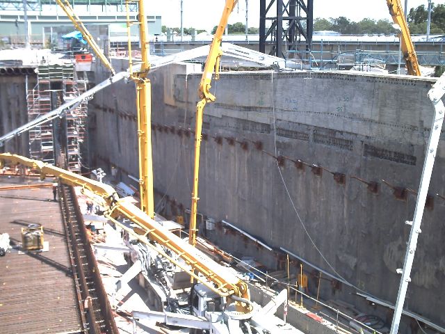

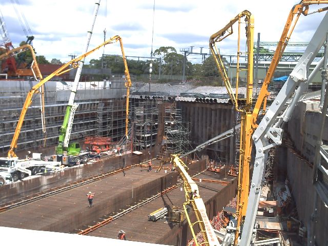

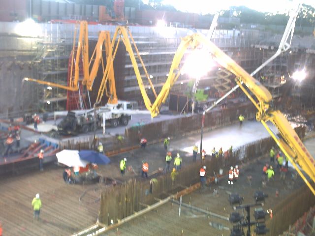

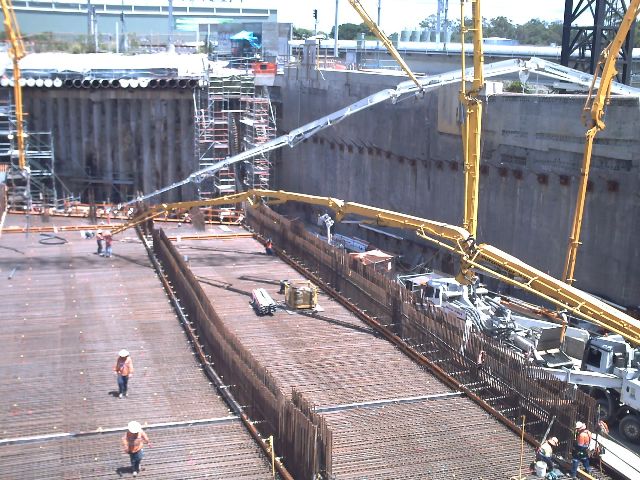

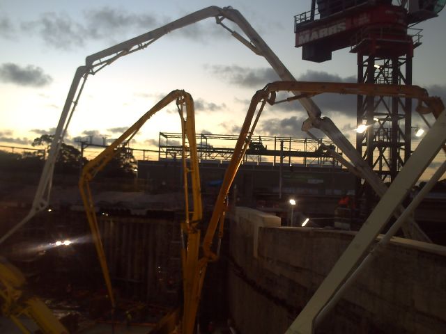

wow, looks like a mess, but i guess its well coordinated :D |

How many brands of pumps on this job. Thanks for the pics |

Looks like a well thought out approach,nice job. |

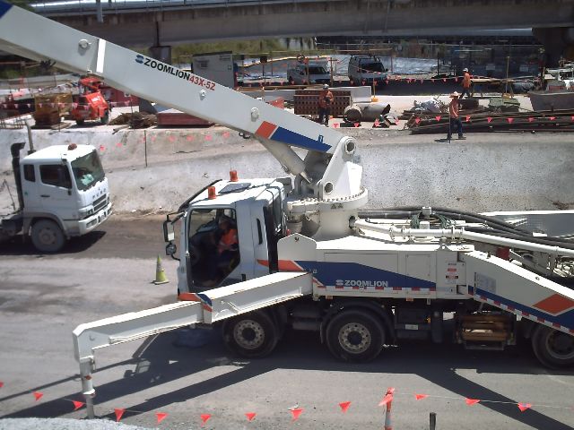

What kind of volume were the Zoomlion pumps able to put out? cu.per hour? |
| pumpaholik | 02-07-2011 | reply profile send pm notify |
1 48m powercrete 1 46m putzmeister 2 43m zoomlions 3 37m junjins |
the 2 zoomlion pumps r rated at 120 a hour i think they go ilright not the quickest or the slowest |

The Zoomlion is rated @ 150 cubic metres per hour As for Pumpaholic comments, ask him who bailed him out on that 2500 m3 pour when he blew his 6" - 5' Reducer. The Zoomlion 43M boom hooked up to his pipeline pumped through his 48M boom with aprox 50M x 5" deck line and a 10M 4" delivery hose pushing it out about 1.5M from the end of the hose. let say its not a fast pump or slow, take consideration of the condition I think it did rather well. The owner (Powercrete Concrete Pumping QLD Pty Ltd) of the Zoomlion 43X5Z is very impressed with the Zoomlion, they are the most economical pumps in his fleet Cheers zoom zoom zoom |

I wonder why they did not pump through the deck pipe from the start. In my opinion a much cleaner option for the pump. Also less fuel consuption. |
