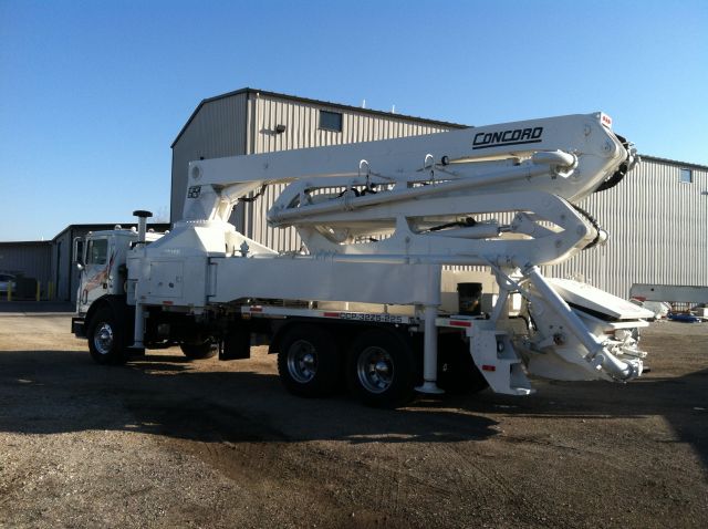

2007 Mack / 2012 Concord 32Z - 5 section |

oh, how i miss that pump, the one i operaterated for 4 years was a 2006. what a great machine that model was to me. got me through every nightmare job the lower main land threw at me.(with alot of line) give her lots of oil filter baths, grease the hoppper like a mofo, grease pins every 2 weeks (work or no) and keep her clean and she'll see u through. and always have 150ft of line!!!! just a tip, take it or leave it. prime folded up except have the 4th up 5th down a touch faster than gravity (around 3 seconds). suck back with 2 sprong balls roped together with water inbetween and boom in the craddle nice and slow. do not juice or over do ur pump out, concrete has a tendency to seg in the 3rd. glhf and use your imagination with the boom |
| ShortStik | 01-29-2013 | reply profile send pm notify |
and take off the hose craddles and cut a drop hose down to 6ft |
| putzman1975 | 01-29-2013 | reply profile send pm notify |
looks like a putz copy cat LOL |
better boom setup than the putz. 5th is on top of the 4th instead of under |
