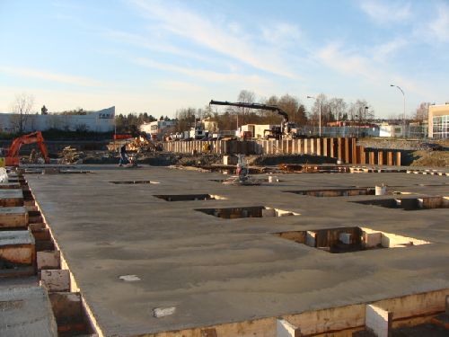

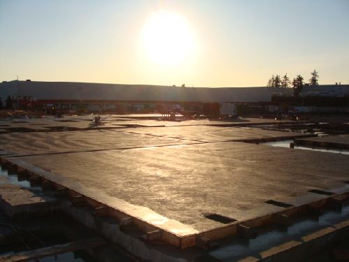

Call Chico call Young from KCP you won’t find better guys in this industry for helping you out. This morning at 8:00AM I started a 200 meter tilt up panel pour with 35 MPA hot water and 1.5% accelerator. Primed the boom everything was good and before the first meter of concrete hit the ground the computer on our brand new 52 Meter Mack packed it in. So no throttle and no way to override the Mack computer. I called Young on his cell and he was at the site in 20 minutes, and Chico was also on the way including a third KCP Electrical technician. Within about 15 minutes Young figured out that it was the computer on the Mack, and with no other onsite options to repair it decided to kill the truck and reboot the computer by turning off the battery isolator. I tried turning off the truck three times before this with no success yet this time isolating the batteries worked and we were back in the game and finished the 200 meter pour in three hours. Washed it out, then getting on the road to drive to Mack and it packed it in again. Anyways the machine is at Mack now and will be ready by midnight. Thanks to Young and Chico my day was a lot better than it could have been. Every time I go by their shop they fixing Putzmeister, Concord, Alliance and KCP, whatever anybody needs these guys seem to have the solution. |

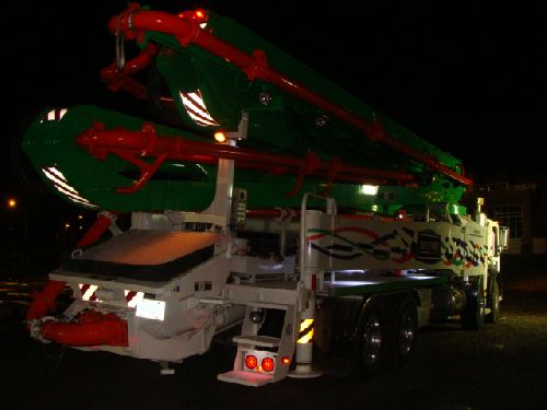

1st Choice, nice photo's. If your MP8 ecu issues persist (and I understand the brand loyalty aspect), Alliance has special solutions to the Vcads challenges in regards to rpm controls and VSS in particular, whereby runtime logs faults and deration is experienced. We welcome all makes in our service department - the Mack issues affect everyone in the industry, and we strive to help. Also, is your DPF Diffuser (bird cage on muffler) slightly in the way of the 1st cylinder nuckle when straight stick directly over that point (about one o'clock postion) ? Mack has been advised of that zone, and allows certain mods to improve working clearances. LW, ACP
