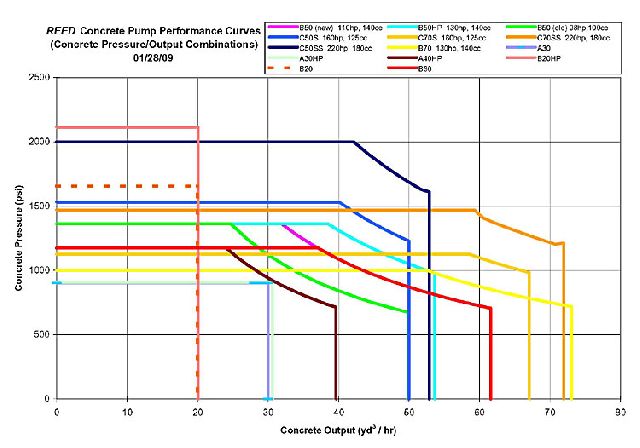

hello - I see on your website that you're running line pumps, so I assume you're asking about those. We have MANY different models that we sell - here's the basic rundown:
REED B Series - these are powered by a 110 or 130 hp (82-97kw) Cummins Diesels. They also have more concrete pressure than the A Series - so being more powerful and having more pressure, they can pump faster, further, and the oversized hydraulic pumps (huge 140cc Hydraulic Oil Pump on B50 and B50HP - mean that they're putting out a LOT of oil, which allows you to keep the RPMs of the machine very low, which allows you to keep the motor at the perfect torque range (it's like a day at the beach for the motor). The B Series pumps have a SUUUPER heavy-duty frame and axle - they have a LOT of steel reinforcement in the back of the hopper/tie rods, etc - so these pumps weigh from 6000 lbs - 7000lbs (2700-3100kg). They are built like tanks, and will last pretty much forever. Used for going up to 20 storeys, or commercial shotcrete, or flatwork (B70). REED C Series - these have a 160 horsepower or 220 horsepower Cummins Diesel to power them, and HUGE hydraulic pumps...these are generally purchased for contractors who have some pretty extreme pumping jobs (pumping in tunnels and mines for thousands of feet, going 30 storeys or more vertically, building dams, dual-nozzle shotcreting, Hayward-Baker soil stabilizing). The bonus is that the Cummins on these is so quiet that you can have a conversation next to it while it's pumpnig full volume. If you take a look at this image, you can get an idea of the performance calculations of many of the different models we offer. As a general rule, the REED Pumps are more powerful (horsepower and hydraulic/concrete pressure) and very heavy-duty than everyone else's pumps. We have excellent assemblers, welders, the best engineers in the business (see http://www.concretepumping.com/dictionary/index.php/Remus%2C_Duane ). We are also known for having a very responsive/timely/helpful parts and department too... If you're coming to the ConExpo show in Las Vegas next month, we're at booth S-800 (near Schwing) - we'd love to see you there! Mike Newcomb |

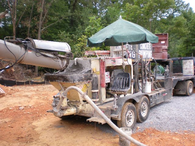

ALMIMA heres my line pump set up |

Biged, that is the coolest pump i ever seen - i realy mean it! It´s so cool to have an umbrella and an old driverseat to sit and wait in the shade for the mixer-truck. I realy like your pump - a brand new shining Putzmeister with polished rims, is not half as cool. |

Right at Christmas time I mounted a 4,000 watt generator up front cause I have had to finish pumping in the dark not any more now I got 8 150 watt quartz lite two per corner about 10 ft high and the first job I pumped in 2011 it was 20 degrees so I took my 70 btu forced air heater and stayed warm not many guys can have that, I learned a long time ago you make you own conditions, plus the 250 gallon water tank in front of the pump is heated in the winter, just plug it in at night just like a home hot water heater, I built it all my self.except the trailer I could have built it but was cheaper to buy than build, I built the truck bed also. |
