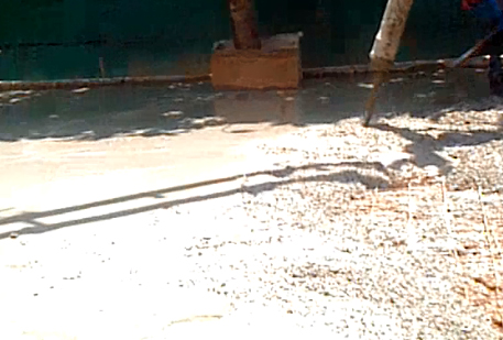

I have putzmeiter brf 1409. output 90 m3/hr., but it would not pump ay high volume . it just a litle more than trikle on end hose. only half of hose dia. any suggestion for me,please. |

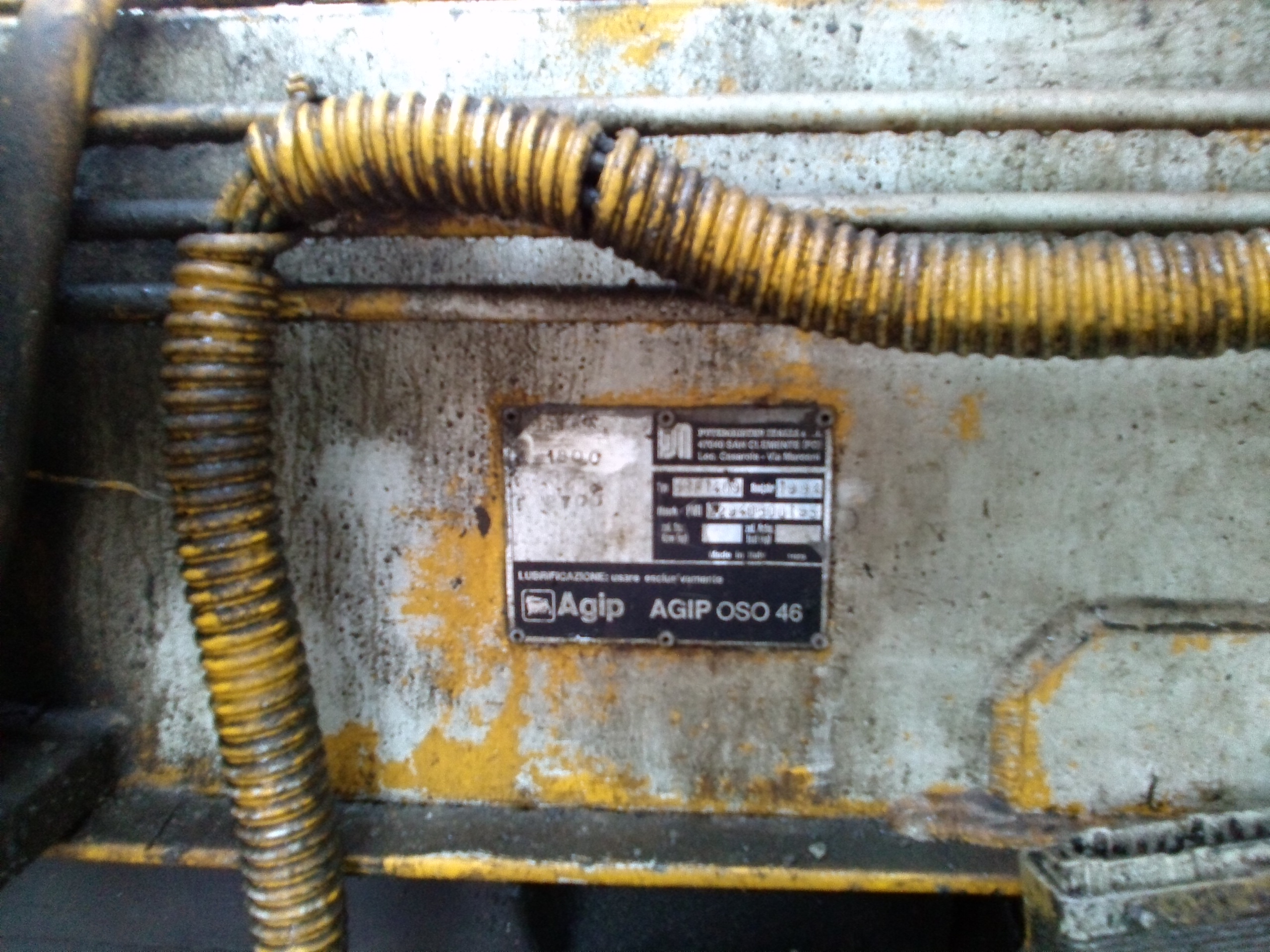

Model : 1994 Menufactorrer: potzmeiter italia This is my plate on shassis |

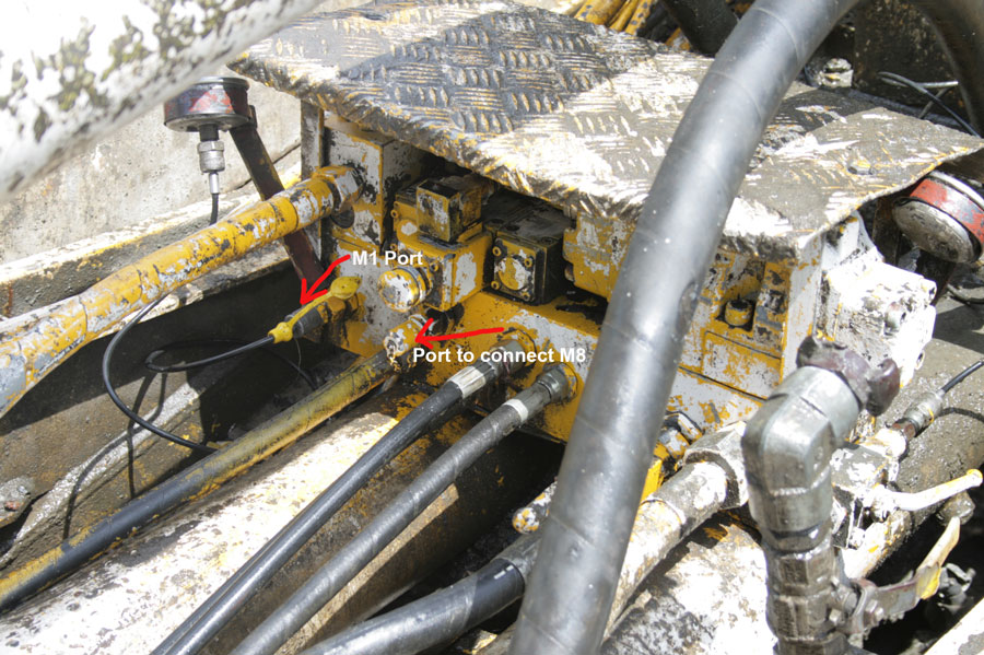

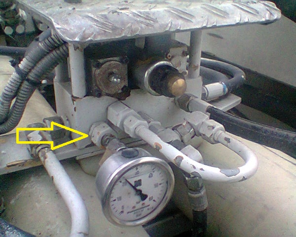

okay first step lets establish your getting full control pressure. Put a 0-60 guage at m8 port located on the control block like the one in picture. The control block is FFH so it should be mounted on the top of your delivery cylinders. At around 1400rpm engine speed (or 3/4 max engine speed depending on engine to pto gearing) the guage with the PUMP OFF should show the case pressure of the main pump which is a sauer sundstrand 6/119 between 26-32 Bar depending on flushing valve setting This is known as your feed pressure.. The machine datasheet found in the manual can give you exact figure if available. When you put PUMP ON the gauge should give you ideally show between 22-24 BAR this is known as control pressure. The difference in pressure between feed and control pressure is influenced by the flushing valve. You need at LEAST 6 bar difference to keep flushing cool oil into the circuit and not to overheat your main pump. You can increase it or decrease it according to your liking. Decreasing the pressure difference to 6 bar gives you true full flow at low RPM. Increasing the pressure difference means you have to have high rpm to achieve true full flow from the main pump. Putzmeister set from factory have variable differences on each machine depending on primarily the HP of the engine and strain of the pumps on engine effect. The lower the pressure difference the harder your truck engine works at lower rpm. Skilled operators adjust the engine rpm and flow manually according to distance and delivery rate of the material being pumped. Let me know what your pressures are and post a picture of the control block. |

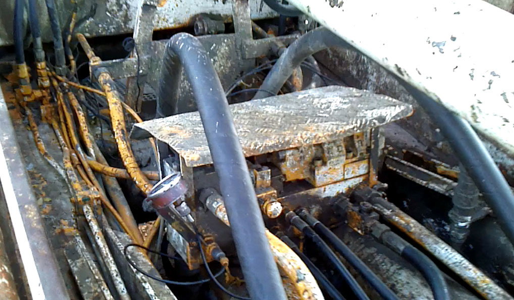

Here ,My conctrol box ,right? |
| PUMBO | 07-01-2014 | reply profile send pm notify |
yes that isthe control block. Plug a 0-60 bar guage on m8. When pumping max rpm should show above 20 bar for full flow. When not pumping should be around 30+1 bar or so...it can be greater than31 bar should not be a problem. On other side of control block there is a Cross like knob. Turn clockwise fully for full flow. Let me know what readings are with full rpm: 1. Pump on 2. Pump off |

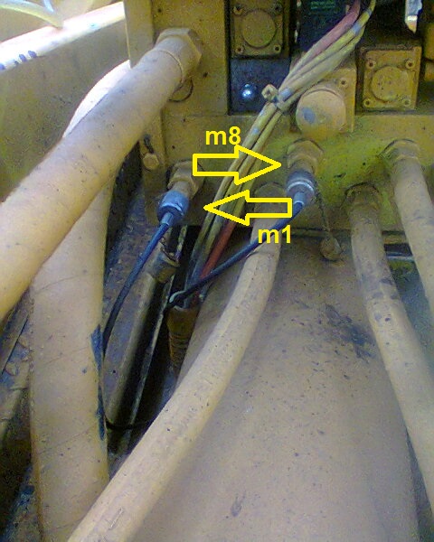

Sorry for late reply.okay let go now. first I show you M8 for my machine.
| somsak | 07-08-2014 | reply profile send pm notify |

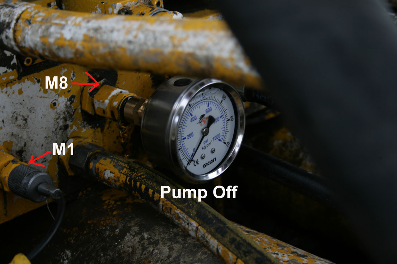

Pump off My pressure gauge not Tilting. No happen |

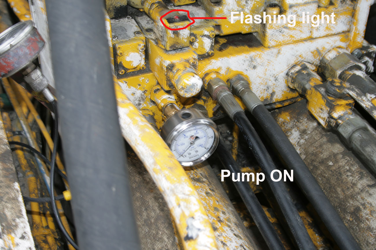

Pump on Pressure gauge is not wiggle like pump off before,But the red light flashing. |

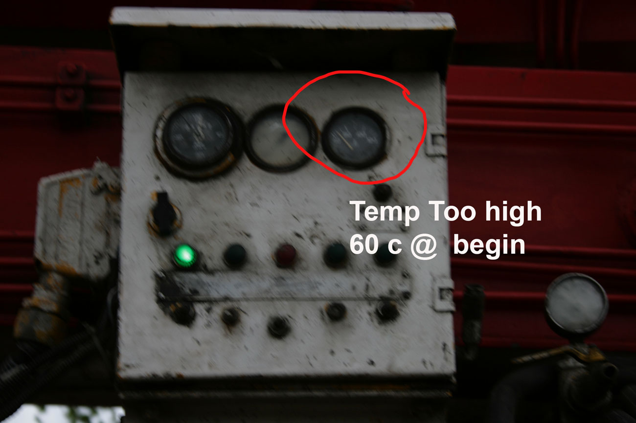

I notice my machine temperature too high at beginning,around 60 ํC @ 1400 rpm. So for long hour concrete pumping it rise to 80 ํC. |
