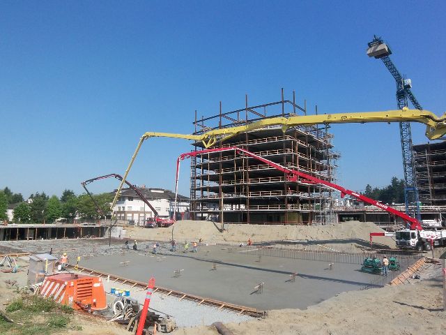

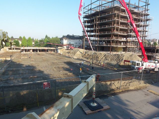

| Todd | 08-21-2009 | reply profile send pm notify |
Nice job, good dunnage and those pads are the DICA? Looks like a fun job. |

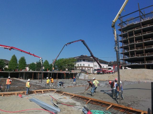

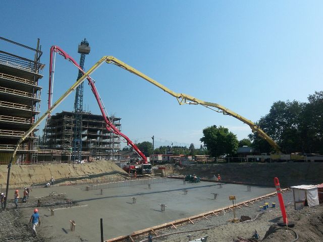

| Many | 08-21-2009 | reply profile send pm notify |
Nice looking job,bet that took awhile.How 'bout sharing some of the particulars.How long and such. |
| 16 CELL | 08-22-2009 | reply profile send pm notify |
We started the pour at 6am, I was folding up the 58M by 11:30am after pumping somewhere in the neighbourhood of 300 meters. The 50M pump made a move and continued pumping until well after 5pm (ready-mix service became an issue in the afternoon) The 40M pump was done at around 3PM.
The pour rate was 120 meters per hour between all 3 pumps (2 trucks at a time for myself and the 50M, and only one truck at a time was able to access the 40M pump.
Poured a 6 inch layer of waterproof mix in the bottom of the slab, toped up the remaining with regular mud. Was nice to get an early start as the temperature eventually got up near 100 later in the afternoon.
The dunnage pads in the pic. are similar to Dica's (which we also have a set of), although Dica's have a much nicer non-slip finish to them. |

how you like the waterproof mix? that stuffs been nothing but a treat for me. never seen it before GVA. love that 58m and the dunage. pump on CELL. hows 40M is that? |
| 16 CELL | 08-23-2009 | reply profile send pm notify |
I find the waterproof mix to be sticky as hell, really gets the boom bouncing... even with the EBC activated. On a positive note, the waterproofing does seem to act as a retardant... which is just fine with me on these hot summer days.
The 40M was formerly part of Able's fleet, My understanding is that it was provided as a loaner from pump Concord. |
