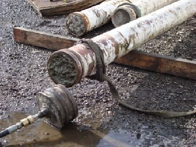

find your nearest hydroblast company and see what they will do it for, 1 section they can clear in 2-3 hours |
| TooTall | 06-08-2009 | reply profile send pm notify |

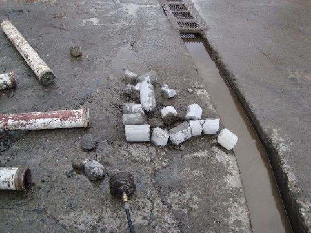

Pressure washer + blow out cap... |
| Pump N00b | 06-09-2009 | reply profile send pm notify |
Was that hardened concrete? Cool, never thought a pressure washer be that powerful! |
| TooTall | 06-09-2009 | reply profile send pm notify |
Some times it pushes out the dual wall insert and it obviously wont work for elbows! Hey butcha, boom pipe full of concrete is called a "Boom Party". When it's hose that's called a "Line Dance", When it's solid stone hard those are called "Fence Posts" HA,Ha,ha... |
