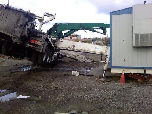

Not a great fan of dunnage then??????,the front n/s appears to have just the plastic pad, as does the o/s rear? |

Look how clean the left rear outrigger green paint is....almost like it was hit with the 'ol photoshop paintbrush to cover up the company logo. Not that it matters. OregonFan, that's what it looks like to me too. Hope everyone's OK-- |

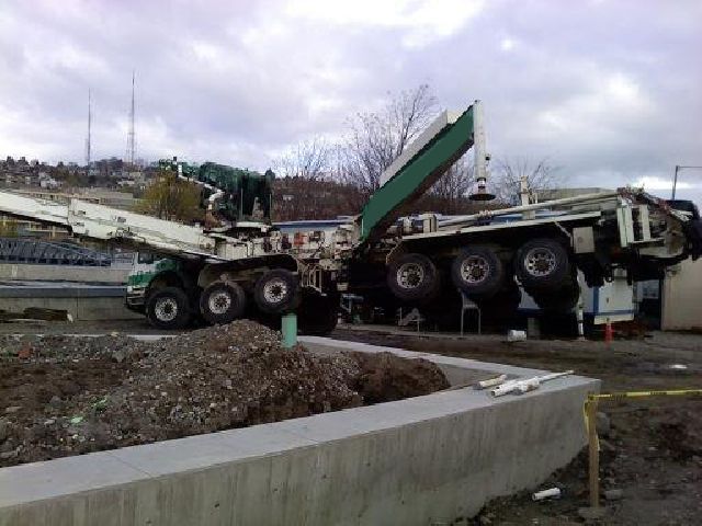

my guess was NW but did not want say anything. we know the ground is soaked look at the three inch water table. i would be hesident at the rear rigger location to take the load. has this guy been out of truck driving school for three weeks or what. |

Another example of people deciding what happened without knowing. What you can't see is the ten feet of foam used just under the grade/concrete. Been out to this job myself, and was never made aware of the situation. No one was hurt on the job BTW. |

The pump is Ralph's. To the person who posted this, (I know who you are but will choose not to mention your name here), the next time you want to post pictures of our pumps, don't bother to photoshop airbrush our name or logo off, we are ok with it. The contractor pulled a tape and instructed the operator where to set up. He set up on what appeared to be the footing of the wall you see in the pictures. All of the outriggers were fully extended and all of the pads were used. What the contractor neglected to tell him was, that under the edge of the footing was one foot of dirt followed be ten feet of styrofoam that was under the pond that the wall is part of. When I got to the job and asked the owner of the construction company who hired us if there was foam under the outrigger he told me there was not. We, along with the L&I inspector, of course found it when we got the pump upright and dug down to find the outrigger foot. Interestingly enough he scheduled another pump company to come out a few days later to do the pour and made no mention of the foam to them either! I did, however, call them and a second disaster was avoided. If this has never happend to you, it more than likley will one day. Remember, ask the questions, make every attempt to find out what has been done on, and under, the ground you are about to set up on, and do not think they won't lie to you! Luckily, this time, no one was hurt. Now you all know the whole story. |
