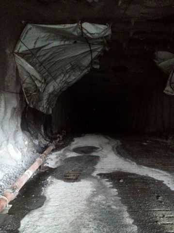

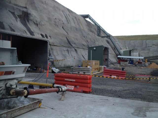

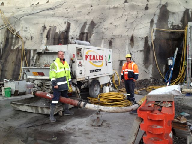

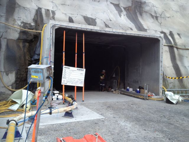

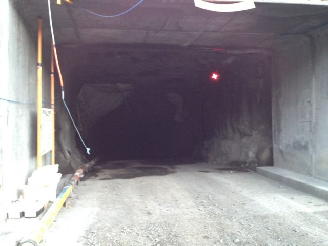

Hi Mate, Specialised Concrete Pumping in Australia recently completed a job pumping 1.2km through high pressure 5" line, I personally was not on the project so I don’t know too much about the finer details, but I am sure someone at SCP would be willing to give some advice. http://www.concretepumping.net.au/index.html I’m with jaybee on this one (WOW) 11.6miles or 18.6km. please keep us informed on the job progress niceunit, got to be some sort of record in this one? |
